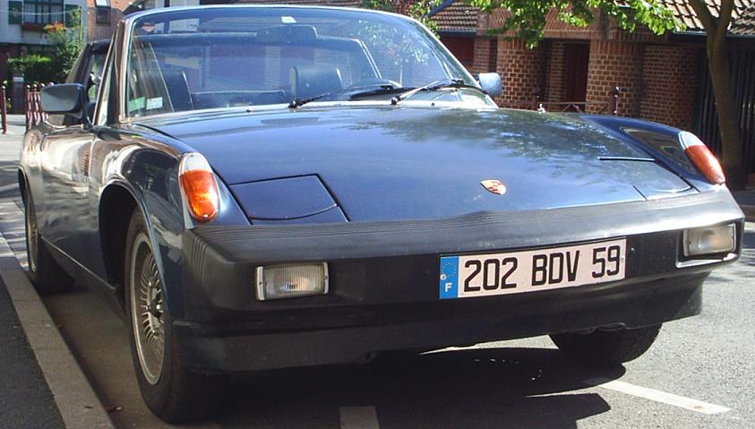

On my 914 2.0 from 75' I have a little problem...
I don't know how is fix the plastic of the front bumper on the body.
My bumper is well fixed but the plastic is not close the hood, it's not nice (see photo) there is waves...
Perhaps I can use glue but I can't unmount the bumper ...
Have you an idea ??
Thanks for your answer and excuse my awfull english language... I am best in french.
Yves - North of france

i have no idea other than to - maybe - remove bumper and glue a piece of metal under the area to hold the area smoother ??

QUOTE(Frenchyves @ Apr 27 2007, 05:10 PM) *
Hello
Have you an idea ??
Yves - your English is fine. You got your point across.
I suspect someone, sometime, removed the front bumper. The, replaced it without proper torque of the fasteners. If it has been like this for some time, it is possible that the part will need replacement.
I'd suggest removing the entire bumper, clean up all areas, replace fasteners (using proper torque settings)& re-install bumper. If, after a few weeks, the bulge is still there, you'll probably have to replace the bumper cover.
Pat

is it possible that maybe the bumper pad is all bunched up in the middle and maybe just has to be stretched out to the sides???
TheCabinetmaker
I'm a 75 kinda guy. Once the rubber bumpers set in a position like that, they pretty much stay that way. I think your going to need a replacement. Bummer!
TheCabinetmaker
On second look, it may just be out of its lip. Loosen the two bolts underneath, pull the rubber towards the rear of the car, try to hook it in the lip, then then pull rubber towards the front and retighten bolts. It "might" stay in.

In order to fix it properly, you will need to go to early bumpers.
If you don't want to do that, I will send you my '75 bumper that I am taking off of my car soon. Pay the shipping, and it is yours for free. It is in very nice shape, but you will need to cut out the rubber so your foglights will fit. Mine is a non-equipped car. Send me a PM, and we can work it out.
