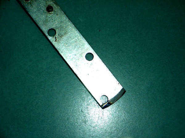

I had trouble with the drag link socket. My socket blade was straight, but the slot is crescent shaped, and the socket couldn't get enouth grip at the end. So I made the tool in the pic. Piece of strapping, ground to curve, then sharpened enough to fit into the slot in the bolt. I pressed it into the slot with one hand, and grapped it with pliers at 90 degrees.
