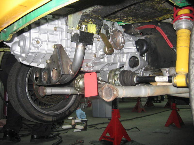

Try this from the pelican board....

Dave_Darling
QUOTE(Mike D. @ May 15 2007, 11:43 AM) *
I thought the idea of running it up side down is that you don't have to flip the ring and pinion...?
Yes, that's part of it. You don't have to flip the R&P, and it allows you to move the engine further down in the chassis for better weight distribution.
Note the missing parts of trunk floor in the pic from the Bird board.
