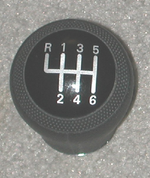

Same as the 901 4-speed pattern. . . .this is the knob I'm using in my V8 conversion. . . .

Ohhhh, nice picture!
I wonder if I can inlay one of those into by 917 knob?

Here's the knob for my V8 conversion.
All kidding aside, the 930 is actually a great choice!
