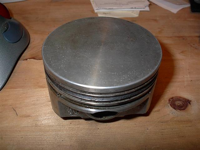

Looks like you'll be good to go. Here's a pic to tide you over til it makes it's way to the left coast:
I'll add in a couple extra wrist pin clips, just in case.
Andy - what are the cylinder's from? I ran into a problem with the jugs that came w/the KB's but that was prob b/c I ran the temps too high. This most recent time around I had Rimco bore out a set of stock 94mm's to match the KB's BUT as long as the skirt clearance is within spec (0.0025 per Jake) they'll be golden!

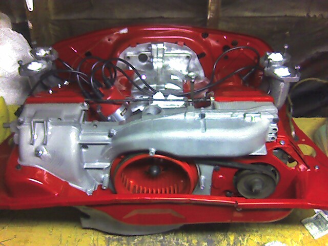

Here's a gratuitous pic of "this most recent time around"... I just put the mag & tin on today....
