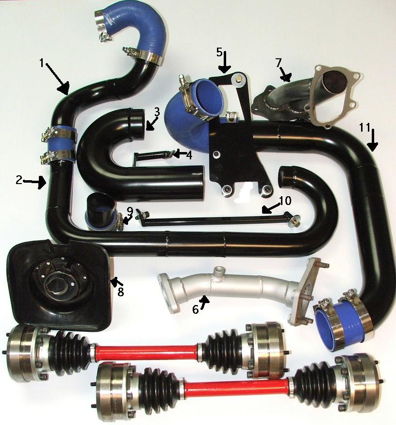

This is about all the extras you will need to get a wrx into your 914 except the shiftrod (also sold by renegade), cooling system, and of course the conversion kit. I built my own wiring harness for my car (pain in the ass), Renegade will modify one for you, or I think BJ went with an aftermarket unit.
I used to work for renegade and actually designed most of the subie kit, all of the pieces pictured are available through renegade, prices are on their site (even though I make them biggrin.gif ) Feel free to PM me with any questions you may have.

Quick answers, the turbo would be in the rear trunk if not re-located. it ends up an inch and a half or so down, and set back a bit. Intercooler gets spun 180 degrees and offset to the pass side of the car. the radiator filler goes to the driver side (so you can fill it w/o removing the intercooler)

Dana's fab work on the stuff pictured is outstanding. fits right, nice welds, etc. I built my own, and think i payed myself about 2.50 an hour for the fab time...
Dana: Are you doing the turbo outlets in 3"? I have more motor than the 2.5" i did will support biggrin.gif

BJ, I just started building 3" downpipes instead of the 2.5" I have one on my car and it flows great.
Don't worry about the turbo heat in the trunk, my plastic battery tray is right over the turbo and shows no sign of heat damage.

How do you guys handle the rotation of the intercooler and inlet connections? It seems like the rather complicated cast I/C connector pieces and formed Y-pipe tube wouldn't lend themselves very well to and changes in direction or alterations?
I've considered using a WRX intercooler in my conversion - since it already has the nice matched I/C to throttle body connection. But the turbo to inlet ports hardware doesn't look very "user friendly" for any kind of reconfiguration work (at least not bolt-on). Anyone have a pic of the underside of the I/C right before you place it in the car - with the connection bits in place?

The intercooler is stock and unmolested the tubing and brackets you see above takes care of the rotation and mounting, it's a bolt on!

That's pictures of the kit that's in my car (prior to shipping)! Do yourself a favor and go with the Renegade engine mounting system too.
see http://community.webshots.com/user/fat73 There's alot of pictures in there of most stuff except for the complete engine mount. I used all Renegade stuff and am glad I did. No problems after 16k miles of driving since 10/06, including a round trip Tampa-Vegas-Tampa to SEMA.
