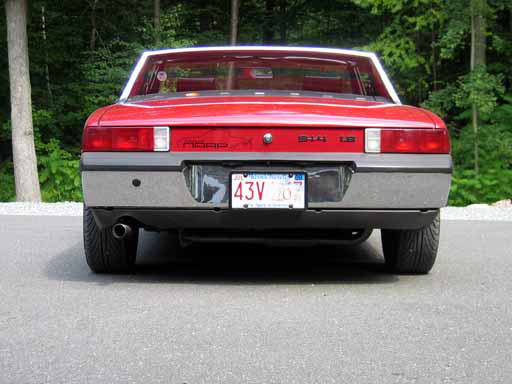

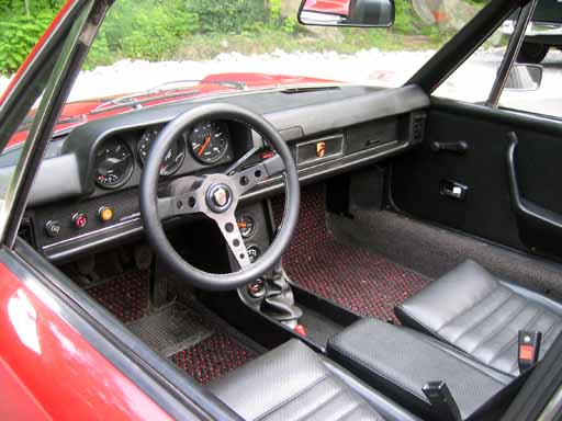

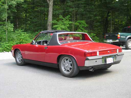

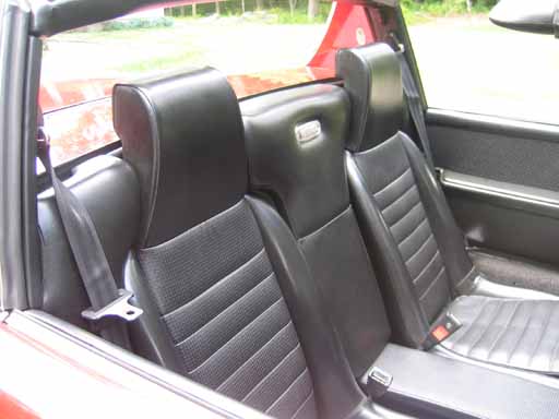

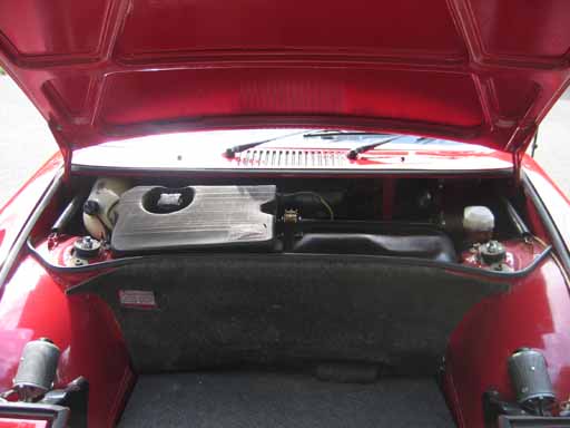

It seems closer to 10%. Here are a few pictures of the car.
swl
Nice looking car! Looks to be in great shape.
