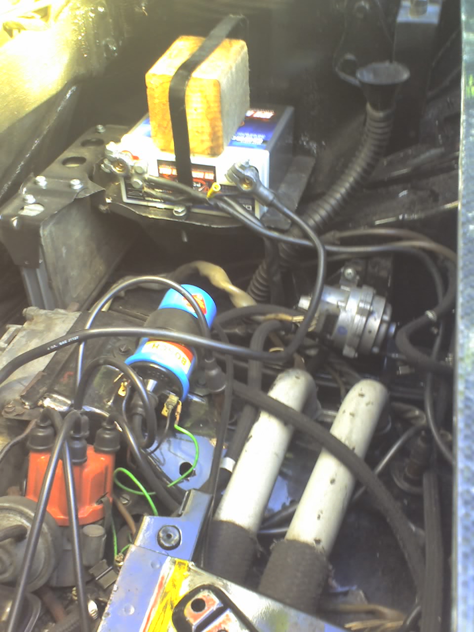

How much weight did you save with the battery? How does it mount on the battery tray?
Chris Pincetich
Optima red top 34 = about 35lbs
PowerMaster D680 = 14lbs
20 lbs OFF for $100 = $5/lb beerchug.gif
Summit Racing has the battery, BUT the post adaptors are not yet at Summit, you gotta order direct from PowerMaster. headbang.gif
My 914 had been sitting 2 weeks - with the new small battery it started up fine beerchug.gif
Fits right in the tray. My AX heavy duty metal battery strap was designed for the big Odyssey. What you see in the pic below is a block of wood to make it fit. I'll fab a new strap this week.

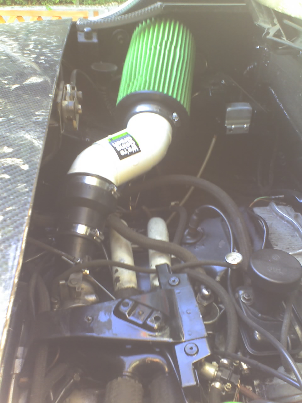

Sooo, the whole air filter thing can be dabated, but my 1.7 has a 1 5/8" 4->1 coated header that relieves back pressure, so I've been dreaming up a high flow intake air filter for some time. After reading Demick's old posts about the affects of moving the intake on his 2.0 over towards the relay board, I had to include the "cold air" intake plan into my project.
Summit Racing web site "Closeouts" had high performance Green ™ filters on sale, so I got one at half price that is designed for a 6L V-8. It costs $37. That should be big enough w00t.gif
Then off to ACE for plumbing parts! Then HOME DEPOT = way cheaper! I plan on returning some ACE parts to save $10. They KEY piece for my project was the 2 1/2" 45 deg bend in black ABS that needs some sandpaper to the inside and it fits perfect on the difficult 1.7 throttle body(?) intake part. Also key was the 2.5->3.5" rubber adaptor that I drilled to fit the vacuum tube from the AR valve(?). Still need to deal with the oil blow-off tube, which used to mount to the air cleaner body outside of the filter, AR tube was always after filter, so I am confident about this placement. My next idea is a oil catch jar to plug the J-tube hole in my tin...or somewhere else.
My test drive resulted in AT LEAST a 15% increase in smiles per gallon beerchug.gif
