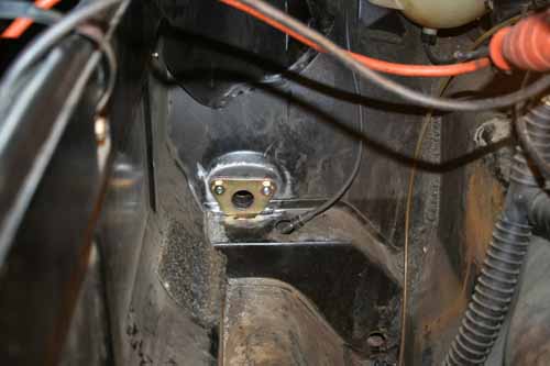

rjames
Depending on how hard you drive it you may want to add backing plates for the bolts in the tank area that are welded on so that you don't rip through the sheet metal.
(Bad explanation, but here's a pic of one of the backing plates right before I welded it in)

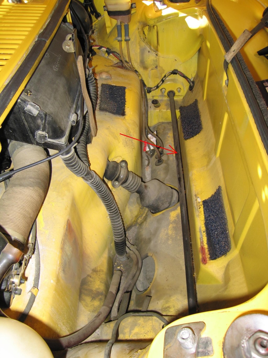

davep
All of the LE cars had them, that makes a lot of 74 cars with them.
Original equipment? Check the rear trunk floor for two little reinforcement pieces. If they look original, then it is very likely a factory installation. See third photo in the first post for an idea of what it looks like:
