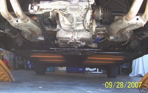

holes drilled in the HE's?

QUOTE(sendjonathanmail @ Oct 6 2007, 12:15 AM) *
holes drilled in the HE's??????
It looks like all of the heating tubing has been removed. Thus no moving air from the engine fan thus no cooling air going into the HE's. He needed to remove the HE altogether or drill the holes. BTW, the holes only work when the car is moving.
I just don't understand why so much time & $$$ would be spent on the engine and car in general, then remove the heating system. Even if the booster fan is removed from the engine compartment, the engine fan would still provide some heat.

purple
in that pic of the SSI's, can you guys see the gap between the CV joints and the output flange? I have this same gap and my CV's are flinging grease everywhere. Methinks he should spend some time on putting in seals and less time dicking with expensive HE's
