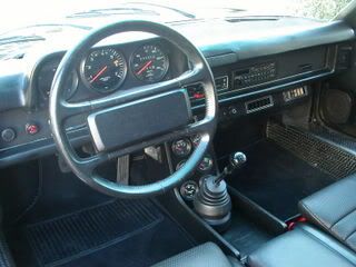

I put a 3 spoke from a '78SC in my '71 and I didn't have to do anything with the splines, they fit fine. I did have to do a little work and make a new brass contact ring that fits in the column for the horn contact and also make a contact plunger that is longer. The SC steering wheel has a "crush" extention on it and to cover this I used various peices from the SC and the 914 to fab the cover. It is a bit of work but it can be done.
