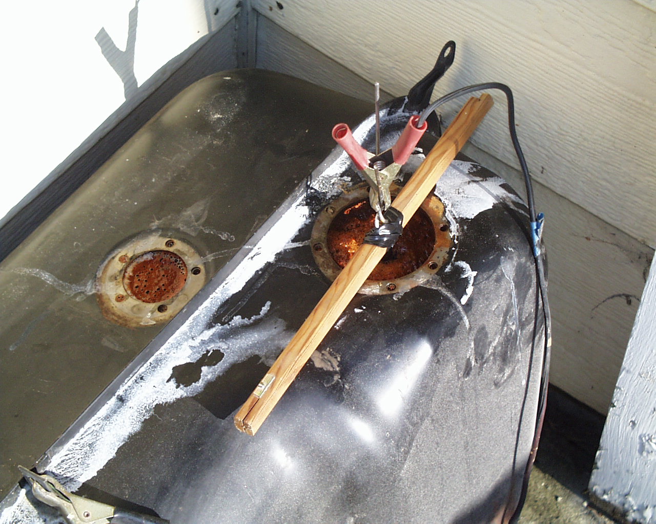

How would you get the electrodes in the tank or do you submerge the whole tank to do it the electric way?
Phoenix-MN
I filled the tank and dropped an electrode (roll of steel) inside the tank.

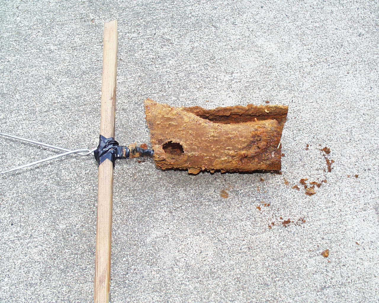

Phoenix-MN
Electrode after a day
