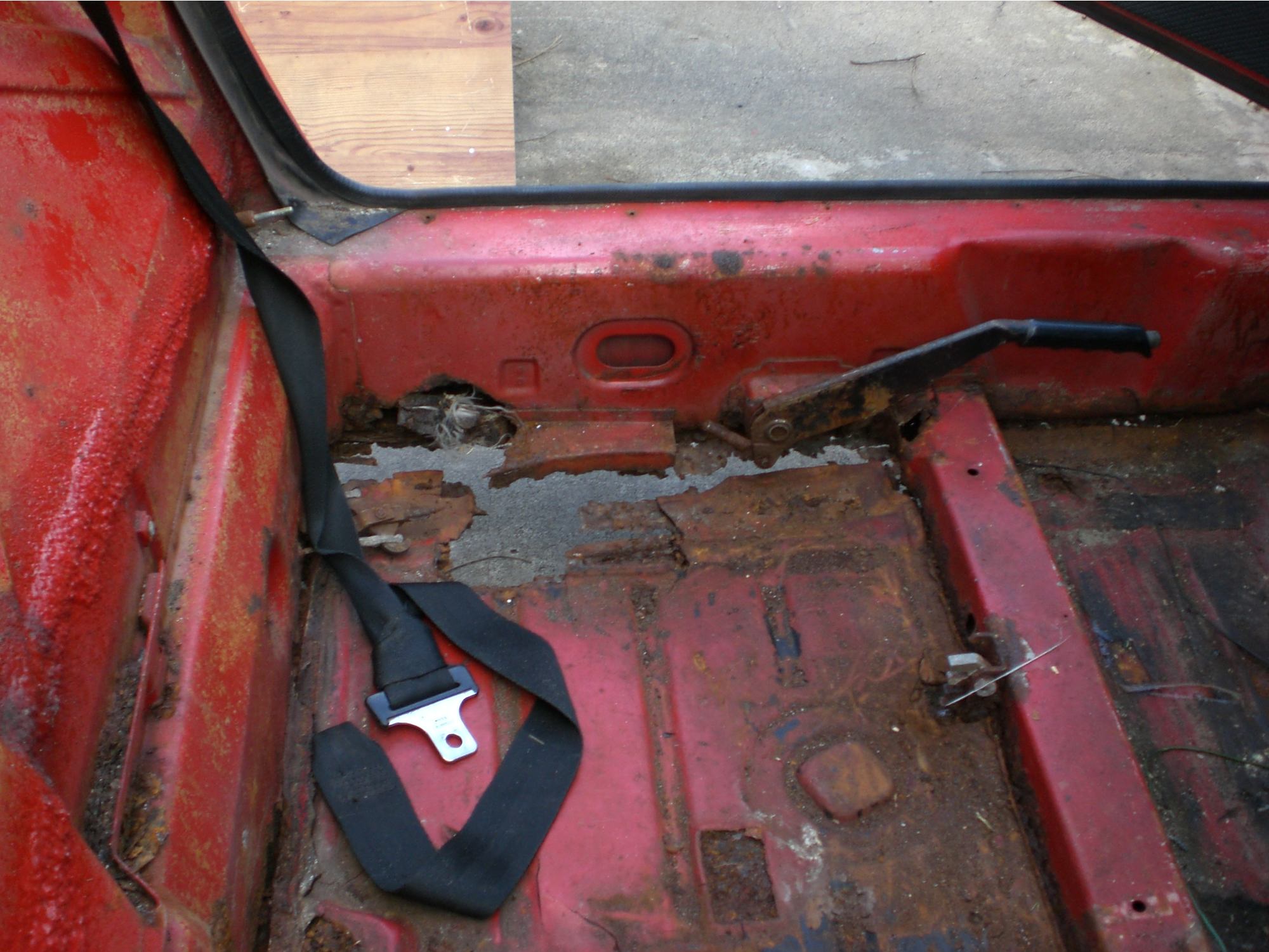

this wasn't the worst area

Wow you got your work cut out, is there anything to weld the new floors too?!!
Plenty of
and fabbing, look forward to seeing your progress.

i am actually paying a guy to fab the pieces and weld them in...there isnt much to weld to...but we will figure it out.
i will keep it updated for you guys

After seeing that floor rot... I think I'm going to weld in some extra material along the seams of the center tunnel, inside longs and both firewalls. So do you stop and go like the flinstones?

I am doing something like this, but my floor is not as bad. In fact the problem areas I am dealing with are the intersection of the floor and passenger longitudinal as well as the rear bulkhead on the passenger side.
It looks like you have little if nothing to weld to on the center tunnel, box section that travels left to right as well where the longitudinals meet the floor. If it was me I would...

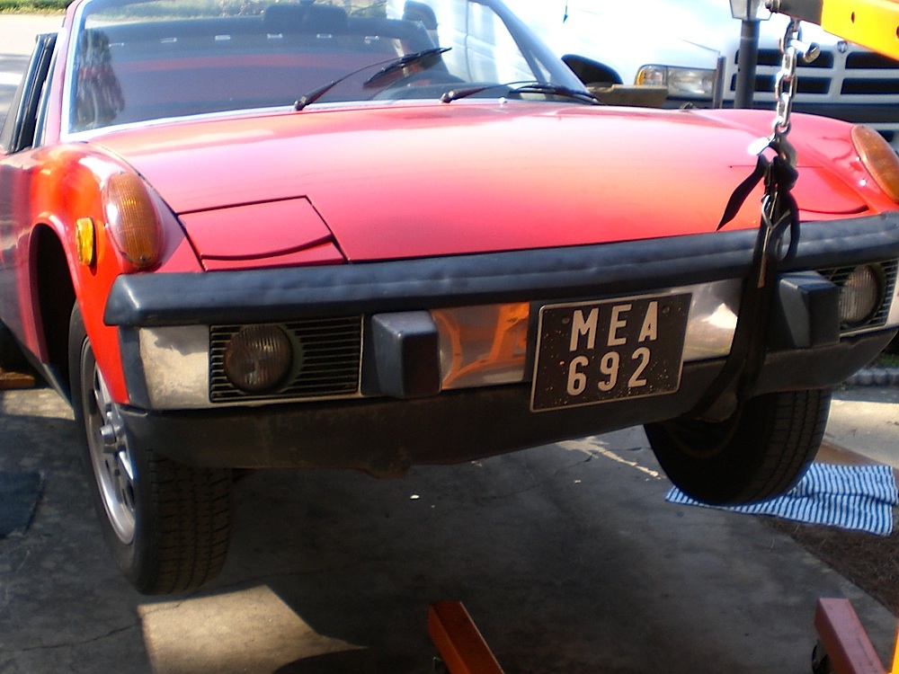

1. Get the car up on some good jackstands so you can work under the car. The engine lift/strap scares me.
2. Drill out any remaining spotwelds (such as near the rear bulkhead) to completely surgically remove the entire floor
3. Media blast and rust treat the entire area.
4. Have your guy fabricate lower sections for the tunnel, lower longitudinal, etc. so that you can have something to weld the floor to. This is to replace the stuff you cut out when you removed the floor itself. It would also be interesting to see how health the bottom of each longitudinal is.
5. Buy a complete repro floor vs. trying to fabricate a replacement.

i didnt see your first post, sorry. thanks for the adivce on the floors...the engine hoist way was actually surprisingly strong...i wont lie.
the problem with the repro floors route is that i have almost all of hte floors already in separate pieces. either A) bought what i didnt have
got for free some pieces C) bought scrap steel...if i hadn't gone through that already i would buy a set of repro floors. but i already have about 80 -90% of what needs to be replaced...
