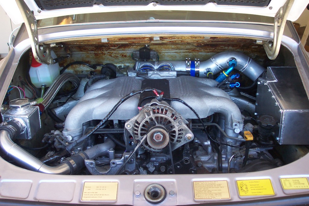

I've got three V8 914's now. 1 LS1 and 2 SBC cars. I plan to convert one of the V8 cars to a Subaru 3.3L (230HP) 6cyl engine. Just got back from looking at a 75k mile great running engine that they were asking $500 for. That works out to about $2 a horsepower.
Heres a picture of a install in a 911SC
