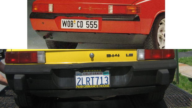

I have looked at pics and pics huh.gif and still can't see anything.
Is there an obvious visual difference. I don't know what I have.
Side to side pics would be great. Anyone?

on an early bumper, the middle where the indent for the license plate is has a sharp radius to the flat plate mounting area. the late bumper has a much bigger radius in that transition.

piratenanner.gif Now i see. So i have the early chrome bumper.
