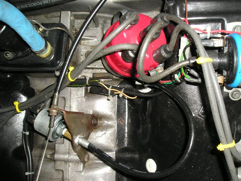

I bought the dual sender for oil pressure and the idiot light. I also got the mounting kit for it that icludes the hose. I was a motard and stripped the hose and now need one I can install with the TIN ON!
This means the hose needs to have a good long extension(around 1.5 inches) so that i can screw it in to the top of the oil cooler without taking the engine out of the car. What did you guys use for hoses for your pressure senders?

Grease gun hose $7

So serious .

QUOTE(southernmost914 @ Feb 27 2008, 10:36 AM) *
So serious .
that looks like i'll be hard-pressed to get a wrench down into the tin to get that fitting tight. How did you manage to put that in? was the tin off? is there a fitting i can buy that i can get a wrench on?
southernmost914
I had no problem getting a wrench in there but I was installing the new dizzy at the time.
