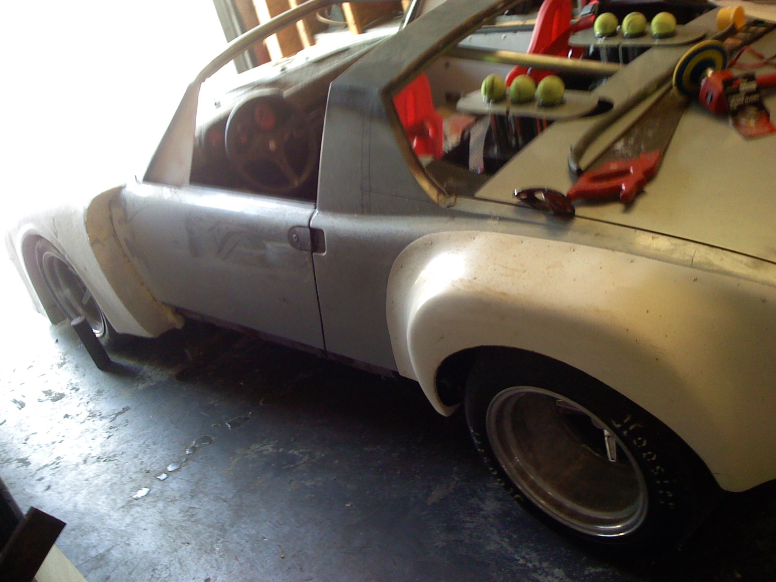

Hey guys, am pretty new here, mostly a pelicanite. Just like to share some photos of my 'projekt 908' which i have been working on for a year or so. I started with a basket case 914 with a standard 2.7 conversion, that had been languishing under it's PO. I had the desire to create something unique and personal, and learn how to be a better welder and fiberglass worker in the meantime. I have always thought the 914 could look must better with a little tweaking... namely a lower roofline and better front end. The 908's front end was always so simple and classic, that it seemed a natural. Started with
Click to view attachmentThen added some flares and centerlock wheels

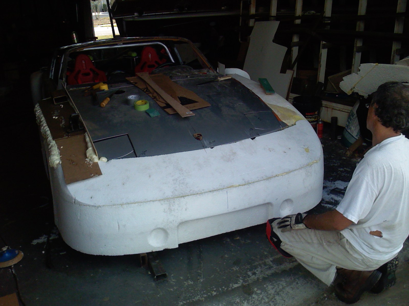

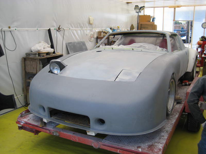

Click to view attachmentThen built a front end out of foam and plater based on photos of the 908/3
Click to view attachmentClick to view attachment

Looks good. Do you know if the new front end is more or less weight than it was originally? What are you going to do for a windshield?
AND
juicersr
Mar 1 2008, 04:15 PM
The front weigh about 40 lbs or so (havent weighed yet)... based on all the sheet metal and that boat-anchor bumper, the weight loss seems great. I live in a beach town, with lots of boat building and repair shops (my partner and advisior in this builds and repairs boats in his spare time), so i made a cardboard template of the 'new' windshield and went to a shop that makes custom boat windshields. The made one perfectly, plus side windows out of 1/4 laminated plexiglass in about a day.
