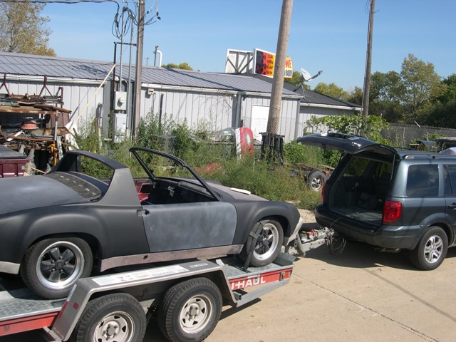

I own a 2004 Honda Pilot, EX-L and have towed my car on a uhaul trailer from New Mexico to Idaho, and Idaho to Wisconsin with no problems. Just make sure you have added a transmission cooler, and take it easy in cross winds because the Pilot doesn't have the weight that a big PU has. I got about 14 MPG for the trip. The U Haul car transporter weighs in at 2000lbs, and the car as it sat weighed close to that as well! Also have towed cars on the uhauls back and forth to IL on numerous occassions!
On a side note, i really like the Pilot. it is a well built, well engineered CAR, BUT the 3rd row of seats are a death trap! small, and VERY close to the rear window. If you need to routinely travel with 8 passengers, I would suggest (shudder) something like a suburban or large van of some kind!
