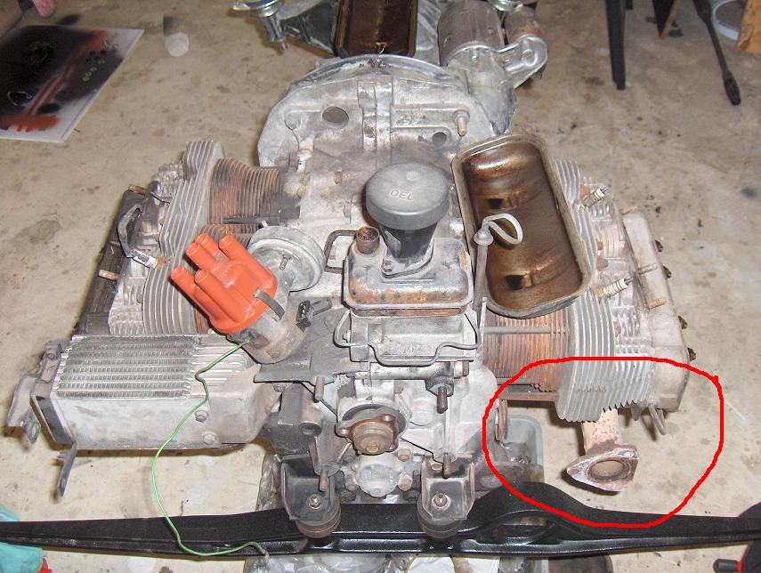

EDIT: here's a pic of what's on my engine. one side is removed (stripped a stud so i left the other alone wink.gif)
Brando
Those are not headers! Those are the regular pipes within the heat exchangers, just without the tin on the outside.
Real headers will merge into a collector much closer to the engine, all 4 pipes together. Not 2 long pipes out the back to a muffler (or in the case of the ad posted, into 2 megaphones... Worst exhaust setup possible.

The picture of the motor shows a stub pipe from a '75 - '76 exhaust.

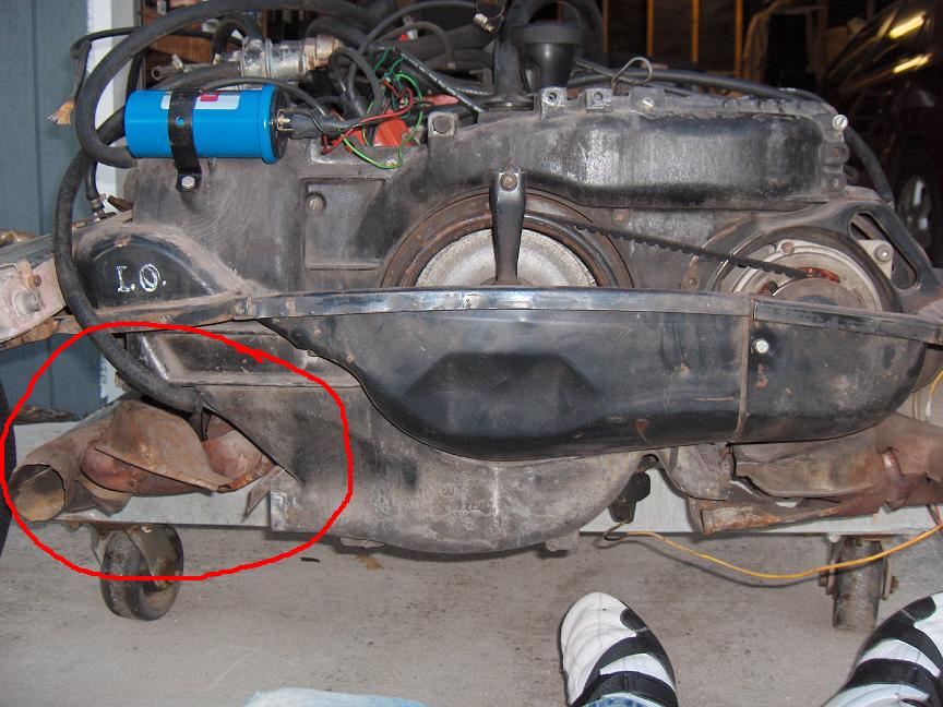

The pipes connect to that stub pipe and kinda curve to the outside and then go back to the rear of the car... here's a pic of when i still had em attached.
stripping the tin from the HE that you can see in that pic there
maybe the HE's are not a type 4 part??
i do recall seeing those stub pipes be called a "bus part" before, so ive always been confused...

QUOTE(stateofidleness @ May 22 2008, 05:03 PM) *
Yep, late exhaust.

Ok, in that last pic, thats the pipe that goes forward for the heater. The exhaust pipes (two per side) are surrounded by metal creating a box, the pipes heat the air in that box and that heated air is piped up front where it keeps your toes warm and keeps the ice off the windshield.
stateofidleness
you said "two per side", which is what im confused on.. when i stripped that "surrounding metal", there was only 1 pipe inside on each side of the engine...
what should i be looking for to replace this setup?
i actually think the stub pipe setup is nice, as you can easily swap stuff without having to remove anything from the case each time.

from day one, up until 75/76 there are two pipes per side, encased in stainless that come off the motor and head towards the rear of the car.
To meet EPA requirements of the 75/76 model years the factory added a CAT. To fit the cat under the car, they turned the heat exchangers to face forward and run a loop back towards the rear (and added a CAT in the extra real estate).
Your system is also more restrictive due to it being one pipe versus two..that also aided in lower emmissions...less flow, lower power etc.
