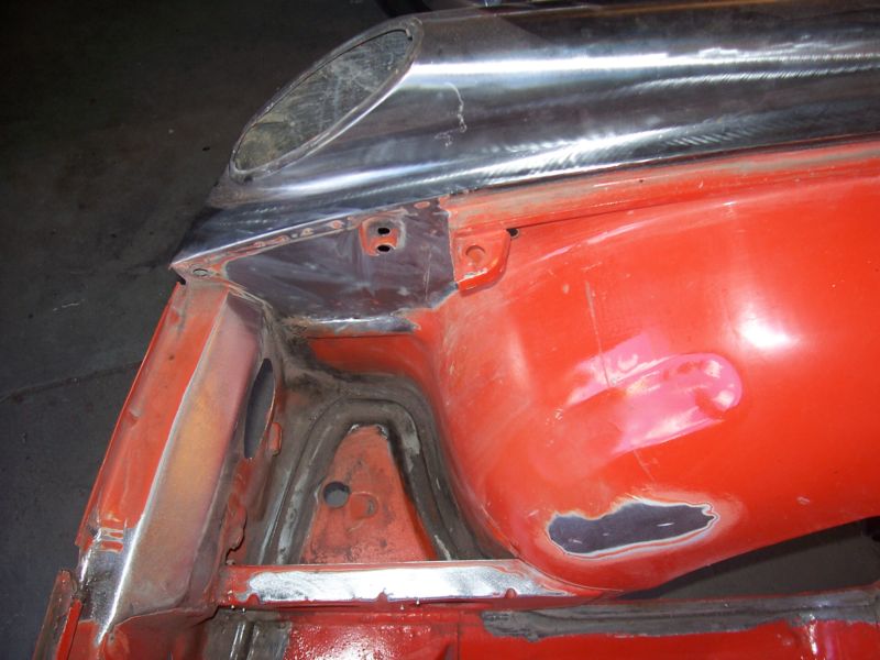

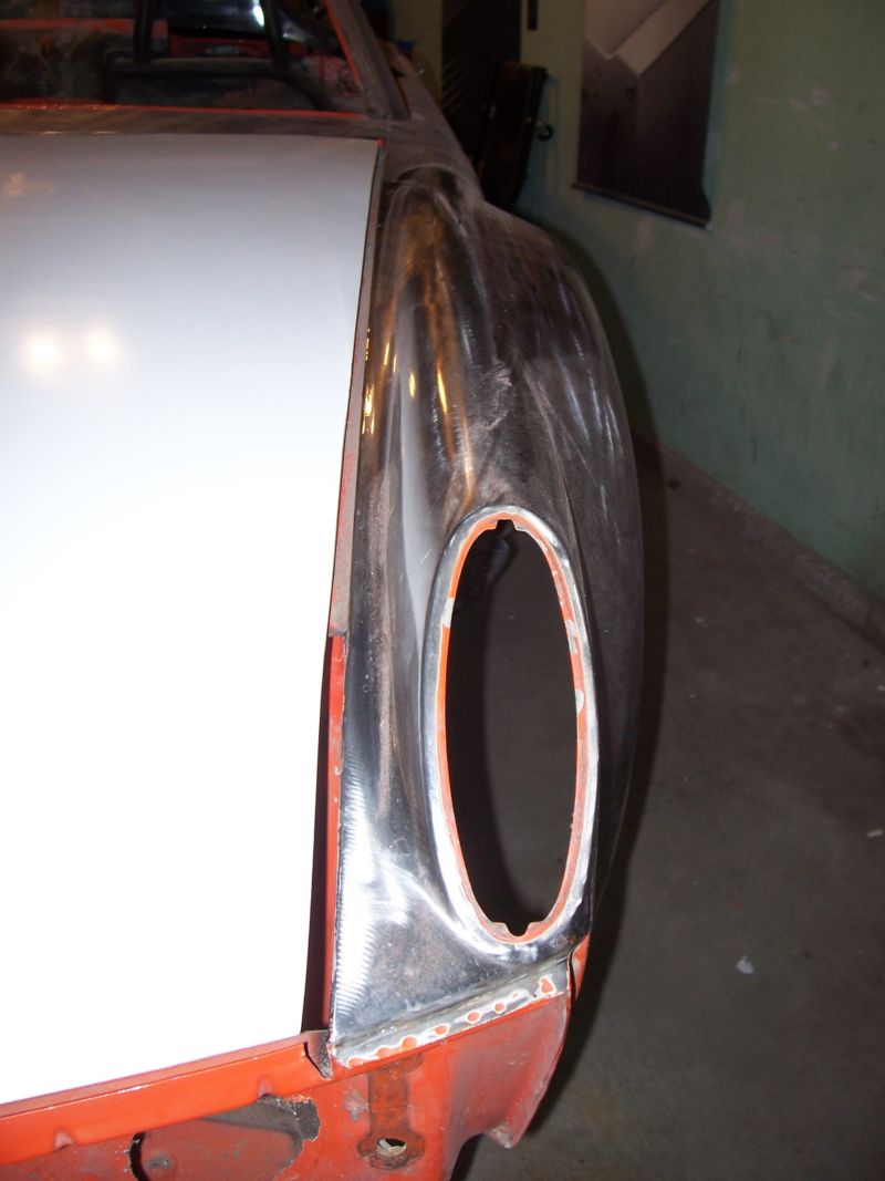

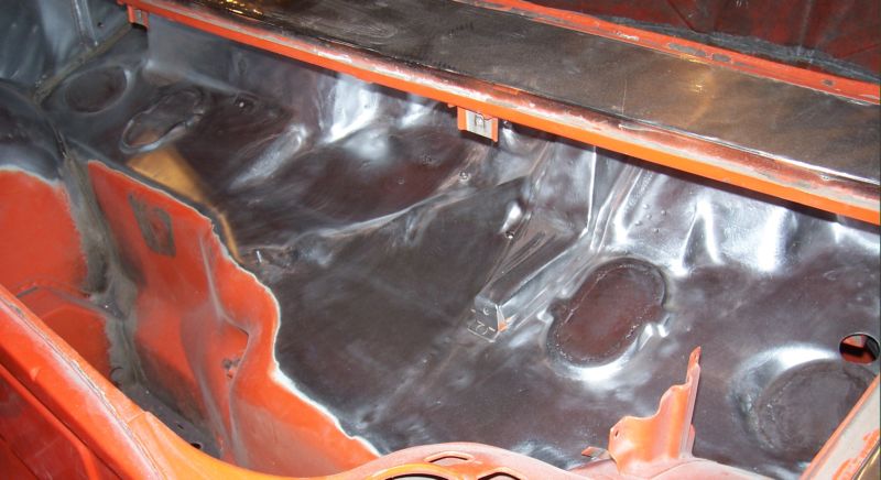

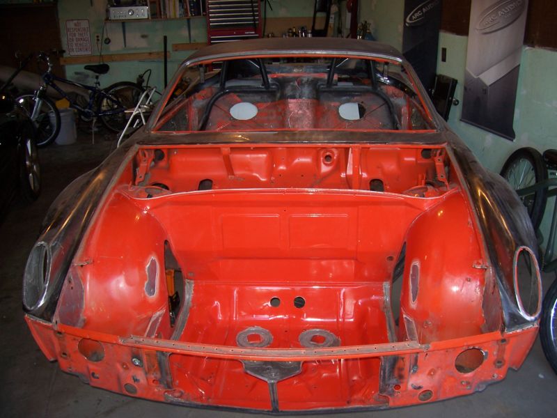

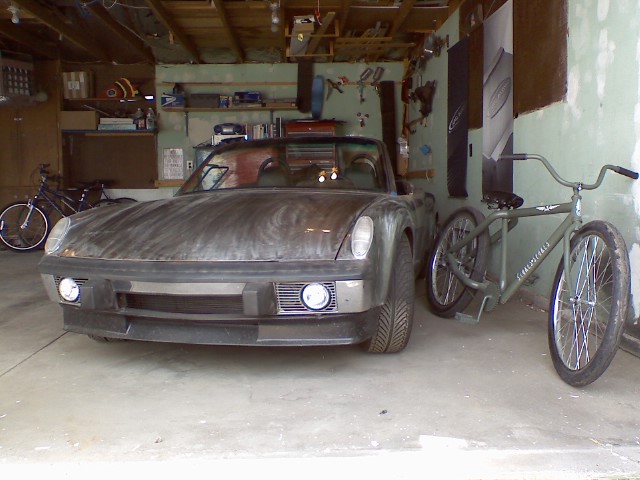

So today I removed the headlight buckets and I've got to tell you it was a lot harder than i thought it would be...
Click to view attachmentDespite putting up a good fight I got them out with out damaging anything
I also scraped out the black tar from the bottom of the bucket.

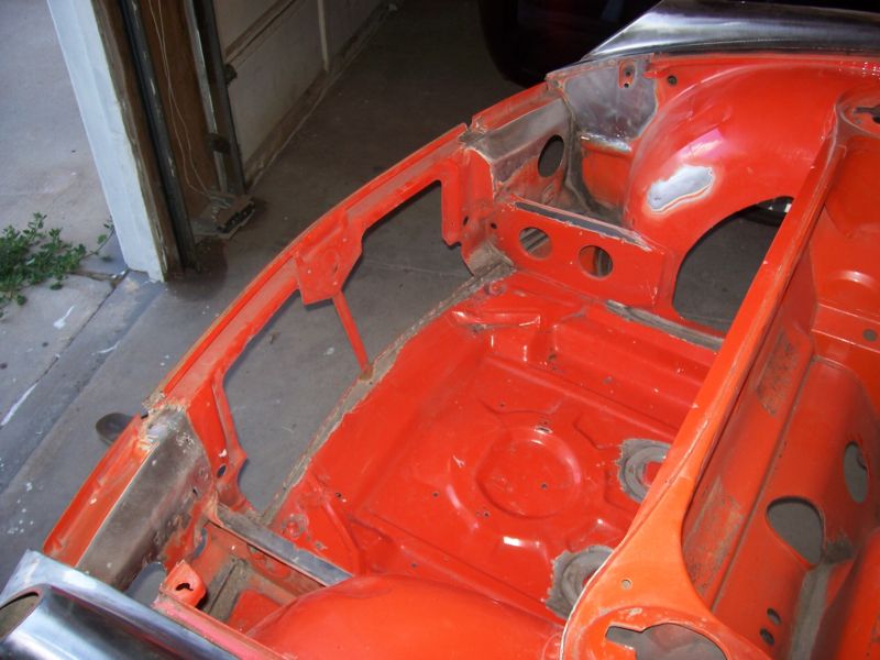

Next I need to make a new hood seal channel for the bucket-less trunk.
Click to view attachmentHere you can see I had already removed the sheet metal that used to surround the spare tire when I installed the radiator the first time.
Also you can see the venting holes cut for the radiator air flow.
Click to view attachmentTo replace the heavy pop-ups I am running KC hilites in the foglight holes.
They are not street legal by any stretch of the imagination but neither is the rest of the car so I might as well stay consistent.
All I know is they work a lot better than the stockers (and look better too!).
Click to view attachmentOver all I cut a total of 21.6 pounds which translates to 3.66 BHP

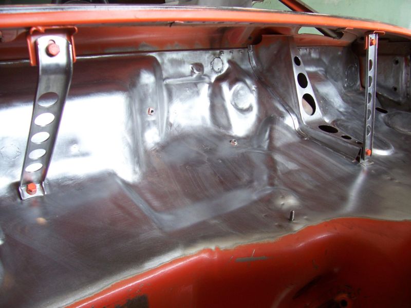

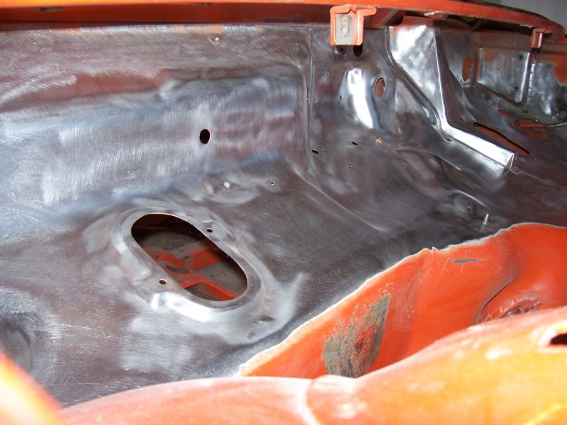

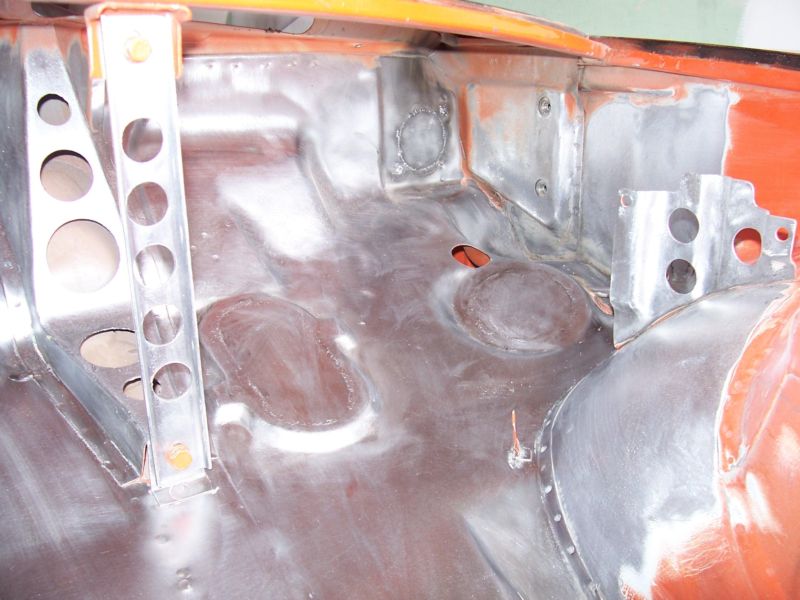

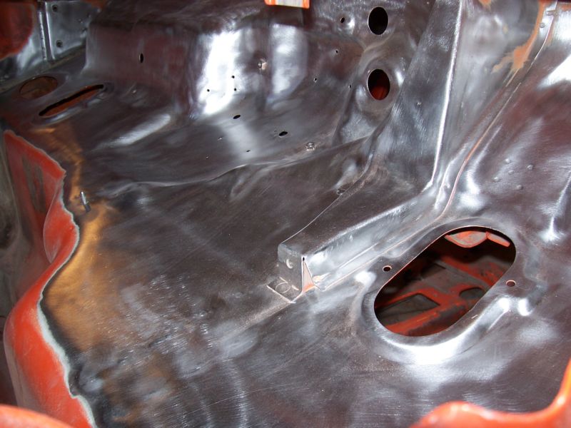

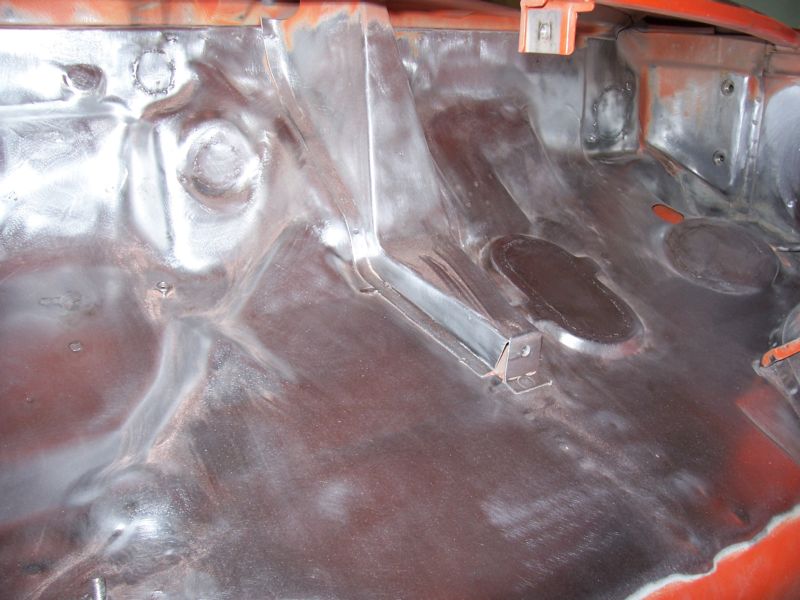

I stripped down the paint inside the cowl area.
Click to view attachmentBetween the original owner and myself we managed to add quite a few extra holes in the cowl that needed to be filled.
Click to view attachmentSince the car will not have any climate control I filled the vent holes along with any extra holes that will not be needed.
Click to view attachmentIt was tough working with the complicated thin metal but with a little high build primer it should turn out nice and straight.

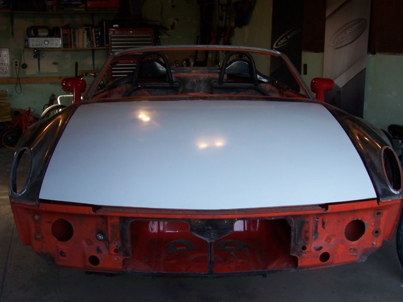

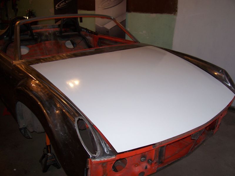

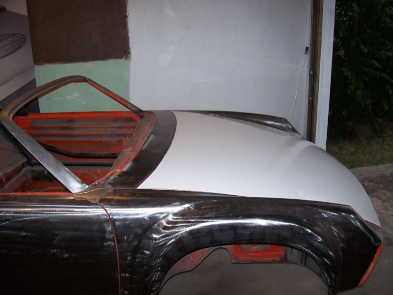

I also received a F/G GT-Racing hood, it weighs 12 pounds for a weight savings of 21 pounds.
This brings my weight savings total up to 427.9 pounds.
Click to view attachmentI am a big fan of Getty's work but for some reason they don't make a 914 hood with filled headlight holes so I had to buy a GT-Racing hood.
Click to view attachmentOver all the hood looks pretty good but it was cut way to small so I have to do a ton of work to make the hood gaps anywhere close to reasonable. Also the filled areas are not supported in any way so they are really flimsy, they really need some kind of inner bracing to keep them from ripping off at speed.
Click to view attachmentSeriously Getty step up, I know you are busy selling parts to the 997 guys but it is time to start making some filled hoods, this hood is going to take years to fix.

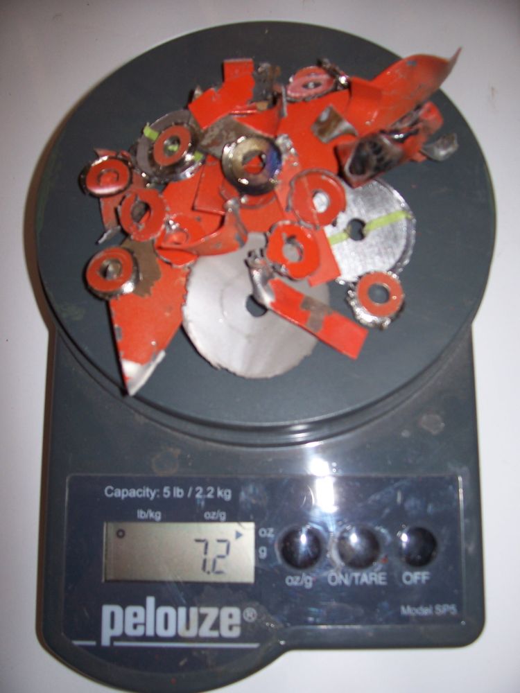

plymouth37
Aug 27 2008, 04:14 PM

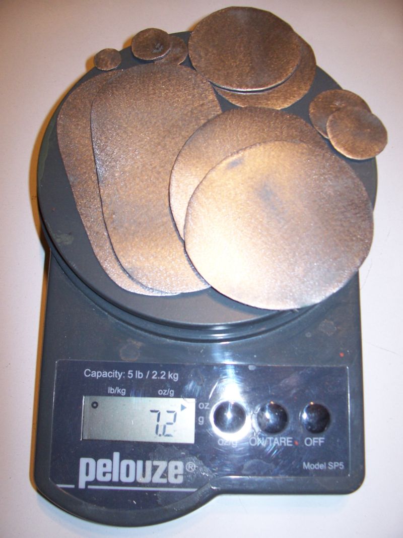

By filling the holes in the cowl area I added about 7.2 ounces.
Click to view attachmentSince this is a light-weight car I couldn't add this weight without cutting some weight too!
I cut off the remaining unused brackets and tabs, whipped out the hole saw and managed to trim off 7.2 ounces to counter-act filling the other cowl holes.
Click to view attachmentHere is the final product:
Click to view attachmentYummy swiss cheese!
Click to view attachmentExpect to see a lot more swiss cheese in the future!

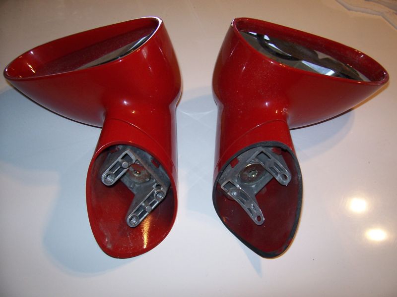

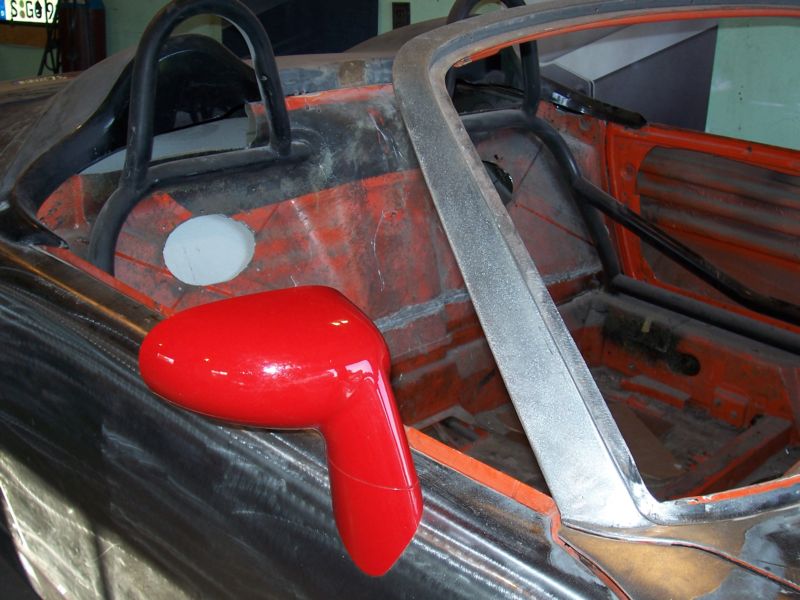

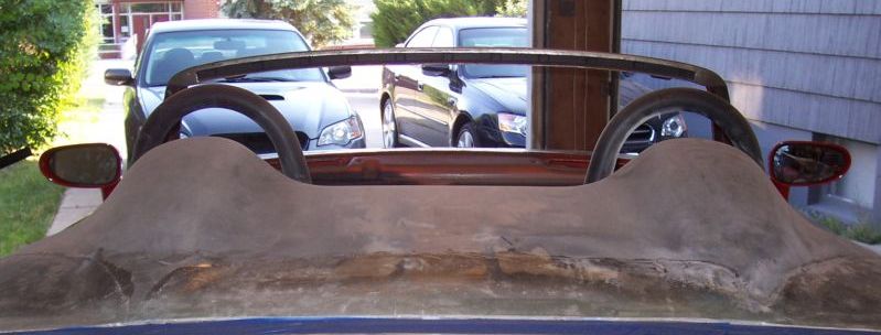

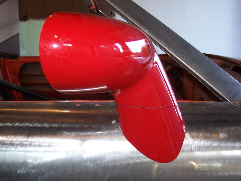

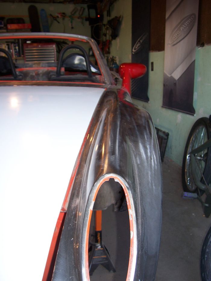

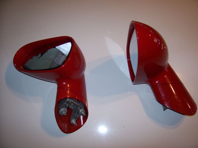

Since I am doing so much to update the the cars looks I couldn't just use the stock mirrors. There are a lot of choices out there but i finally settled on 2006 Pontiac Solstice mirrors, they are quite a bit smaller (and cheaper!) than the Porsche Aero mirrors and I think they fit the cars style pretty well.
Click to view attachmentClick to view attachmentHere is what I had to do to make them fit. I had to grind down the base to fit the contour of the door, then drill and tap deeper mounting holes. It was actually pretty easy to mount these mirrors, overall it took about an hour.
Click to view attachmentClick to view attachmentClick to view attachmentClick to view attachmentClick to view attachmentClick to view attachment
PeeGreen 914
Aug 30 2008, 02:06 AM
Those look surprisingly amazing.
roadster fan
Aug 30 2008, 05:51 AM
Yup, I think they look good with the style of your build.
Jim
byndbad914
Aug 30 2008, 03:24 PM
jesus dude, those look like a factory fit. nice work!
