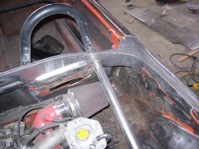

I have decided to run 5-point harnesses so it would probably be a good idea to triangulate the hoops with another bar.
It will be tough to squeeze another bar under the humps, I will have a better idea of what is possible after I finish the firewall.
Very cool project! To triangulate the main hoop a little more, why not just put a diagonal tube laterally behind where the seats will go?
The main hoop is not the issue, I am going to run a bar diagonally from the rear up to each head hoop to keep them from folding if the car flips.

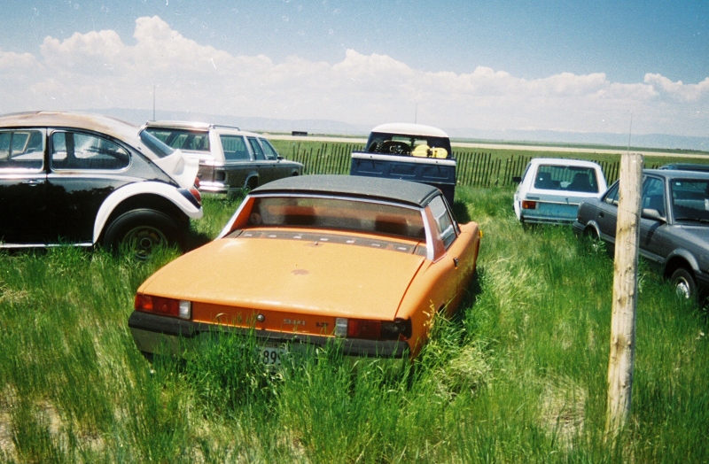

While moving I stumbled upon some old negatives from the day I found the 'biter and have added them to the first page of the thread, she has come a long ways huh?

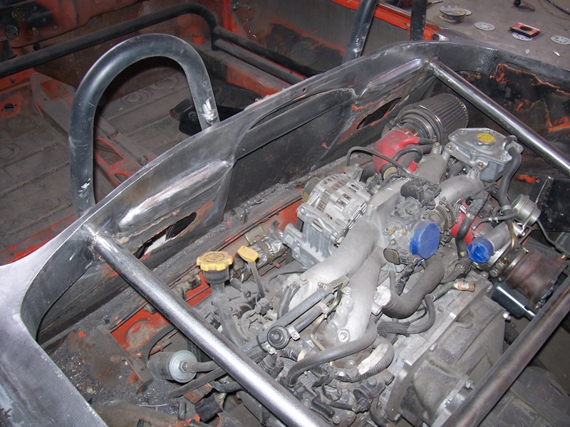

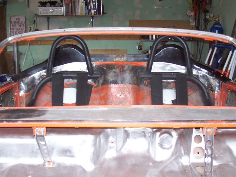

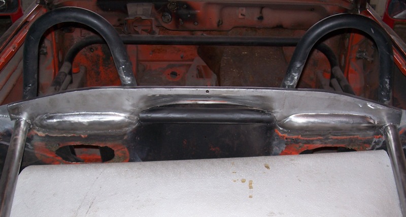

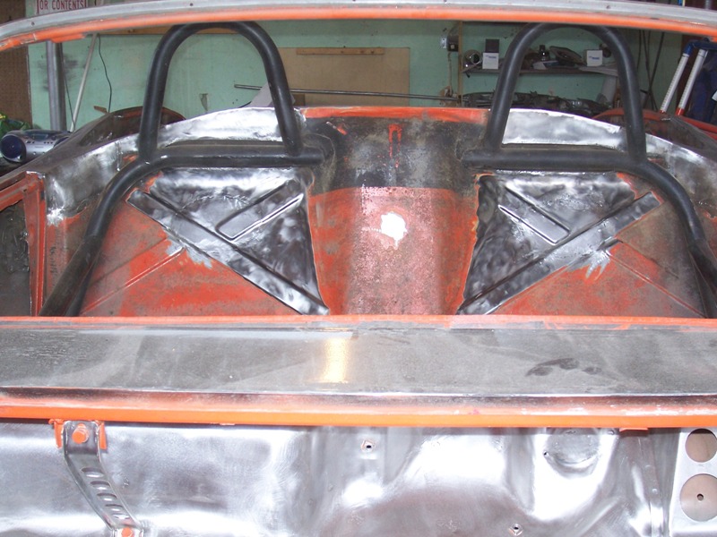

It's sping break and I finally had some time to spend on the car. As some of you may know I moved down to Boulder, CO in January but my car is still in Laramie, WY. I drove up on Sunday and was finally able to make some progress on the car.
I started out by welding in the center beam for the new cross member.
plymouth37

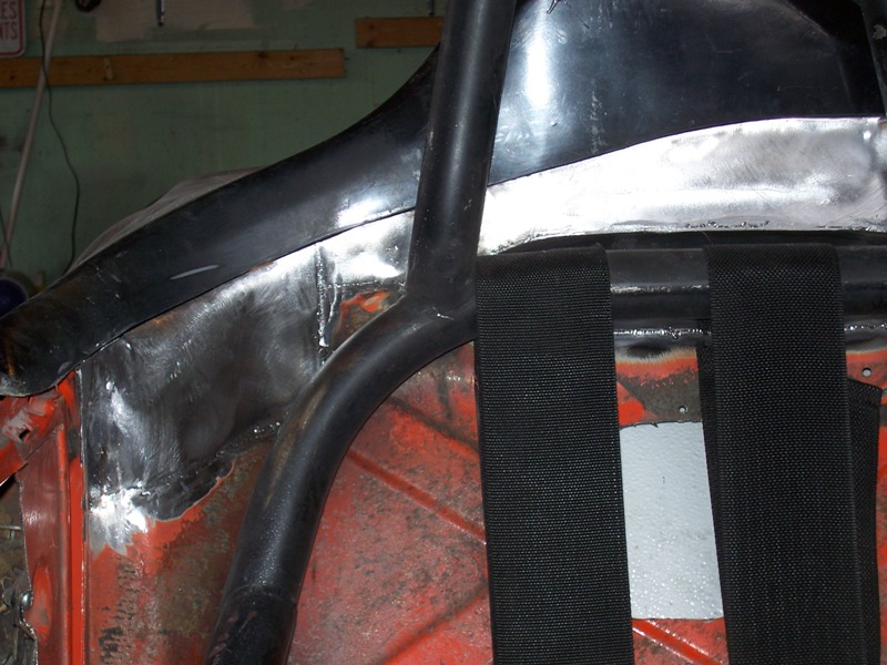

Then I welded in filler panels for the corners, as you can see they are crazy pieces that needed a lot of shrinking and stretching to fit.
plymouth37

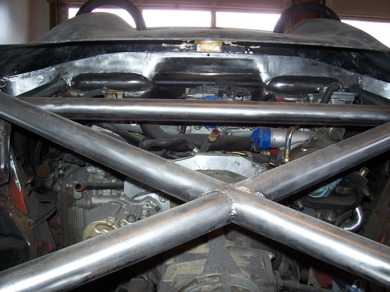

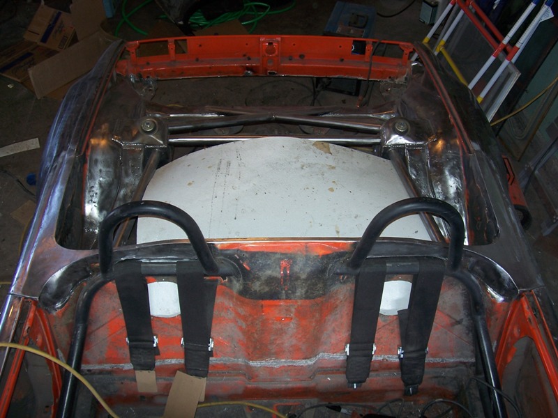

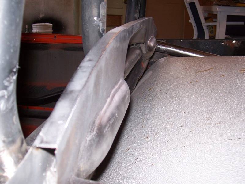

Then I moved on to the most complicated piece of the cross member. I was remembering a 550 spyder I had worked on years ago and designed the cross member to echo those lines.
plymouth37

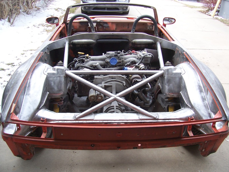

I finished up the cross member by capping it's back and bottom.
Here is the firewall with the humps on. I think the gap between them turned out pretty nice.
plymouth37
Here is a cool pic from the trunk looking into the engine compartment.
Not much left of her...
plymouth37

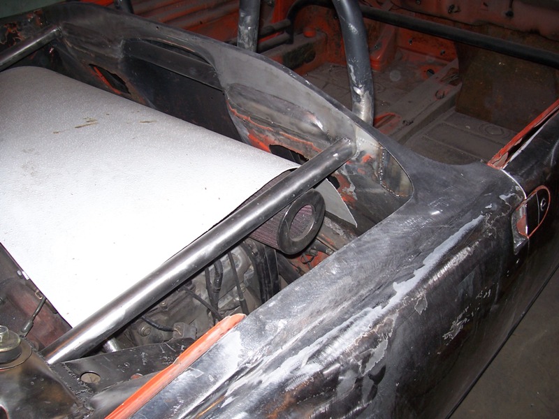

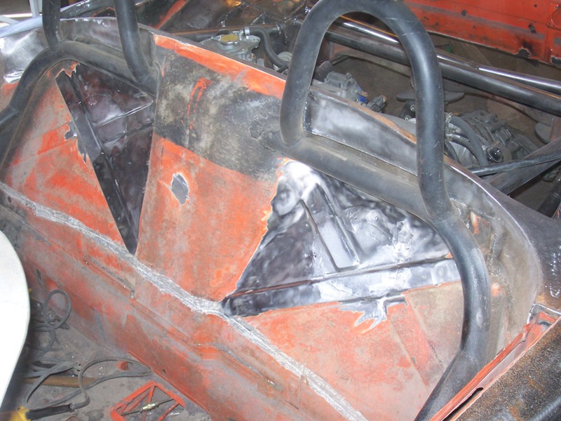

To finish off the fire wall I welded in some patch panels to fill the holes left by the speakers.
Thanks to Leo Imperial for getting out his sawzall and cutting me the perfect patches!
