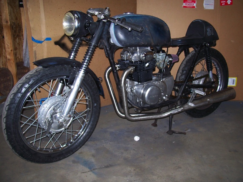

I finally got the car moved down here from Laramie a couple of weeks ago, so now I can actually work on it.

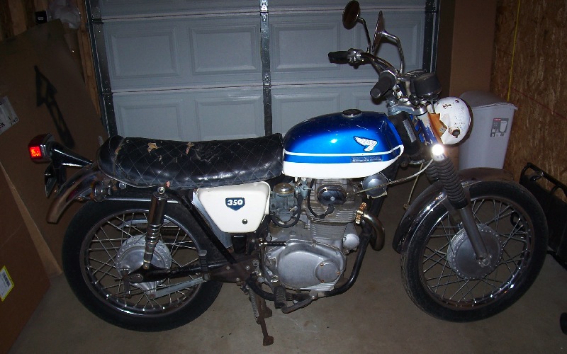

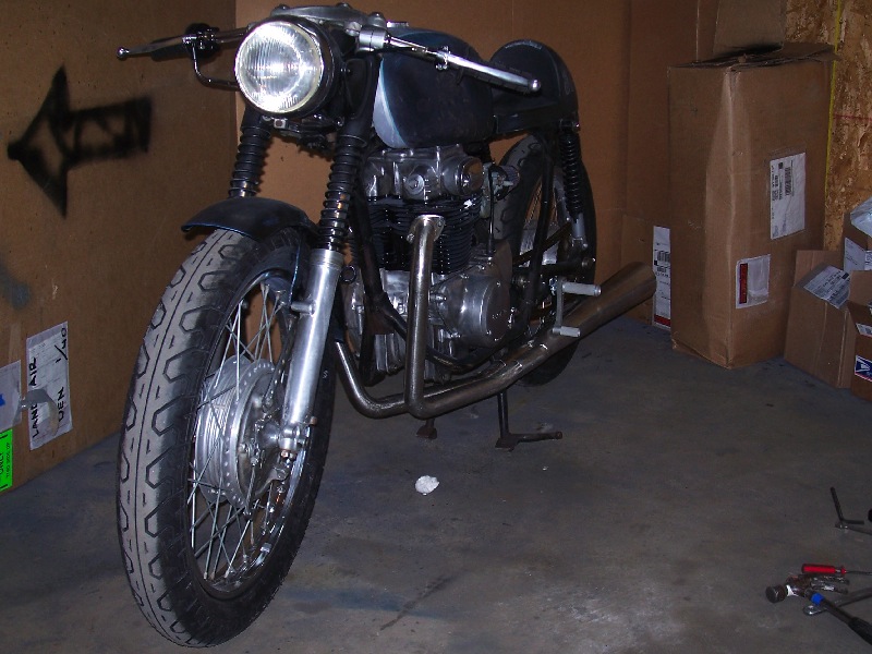

While I was waiting for the car to make it down I decided to stay busy and started building a vintage cafe racer. I am almost done with the bike and will start back on the Anklebiter in about a month.

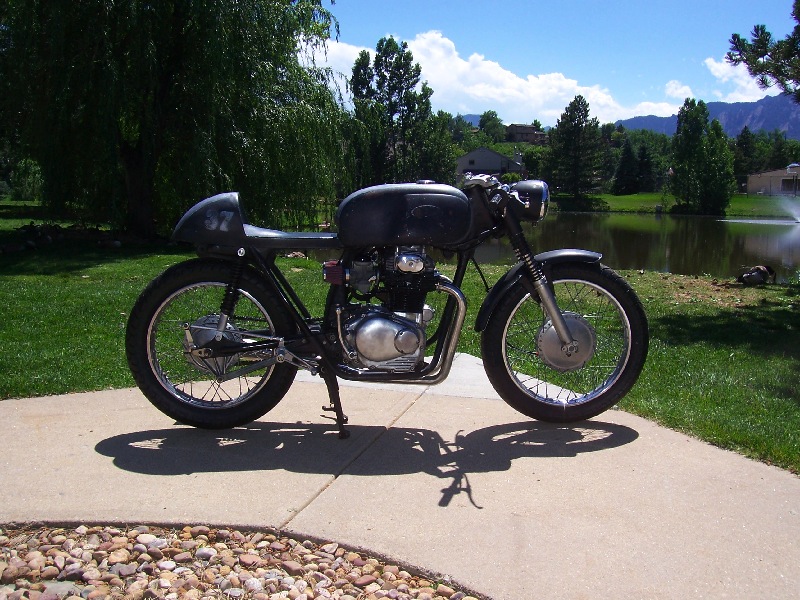

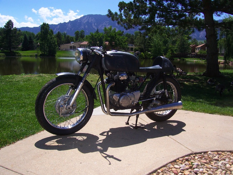

Here is my excuse for not working on the Porsche, 1970 Honda CL350 with many custom bits.
If you want to check out the Build Thread for the bike you can find it
Here.Before:
Click to view attachmentNow:
Click to view attachmentClick to view attachment

Dana, I just have to say... I hate you...
in the nicest way possible
. Nice work. You have some seriously mad skills. Sweet bike. I have an old Yamaha I need to fix up some day.
Wes V
Jun 6 2009, 08:24 AM
The motorcycle is major cool!!
I particularly like what you did with the paint.
Wes

Click to view attachmentClick to view attachmentYou have a great eye for design.

I just finished up the bike. I just need to re-configure the garage to work on a car instead of a bike and then pull the car out of storage. Work on the Anklebiter will resume soon!

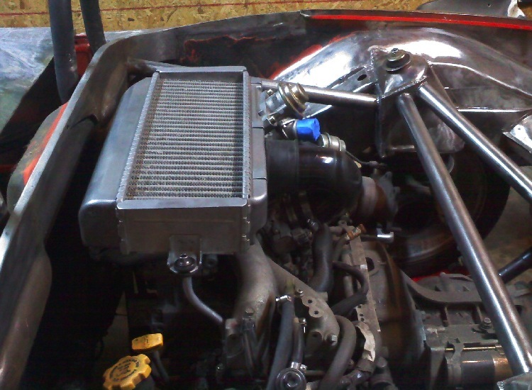

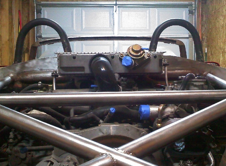

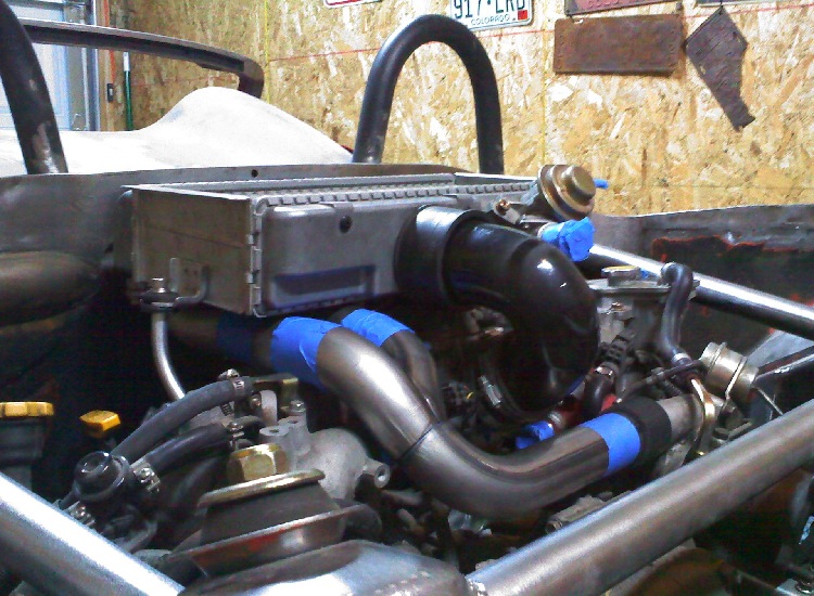

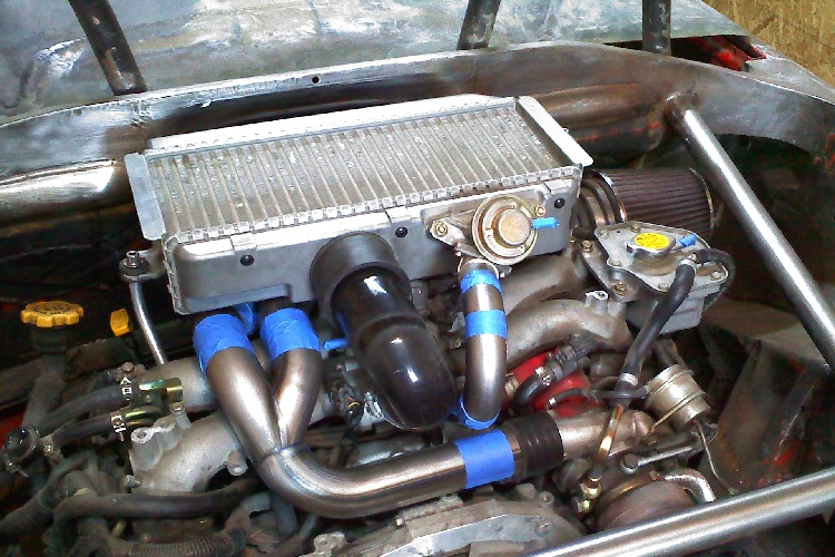

So after almost a year of down time I have finally started back into the car.
I was originally planning on running a custom intercooler. After playing with the stock one and calculating flow rates of other aftermarket intercoolers it became pretty clear that the stock intercooler was a pretty good fit for what I needed, and it's free! I will just have to get its fins straightened and give it a good cleaning and it will be ready to go.
I am going to cut subtle but effective venting slots in between the head humps and use a couple small electric fans to draw air into the intercooler.
To mount the intercooler I threaded a couple 1/2" aluminum bars at each end. One end screws into the engine block and the intercooler bolts into the other end. I think they look pretty clean and they are surprisingly sturdy, most importantly they weigh almost nothing.
Click to view attachmentClick to view attachmentClick to view attachmentI wanted to get a start on running the inlet tubes for the intercooler but out of the thousands of feet of tubing I have none of it is 2", looks like I will have to hit up the exhaust shop tomorrow...

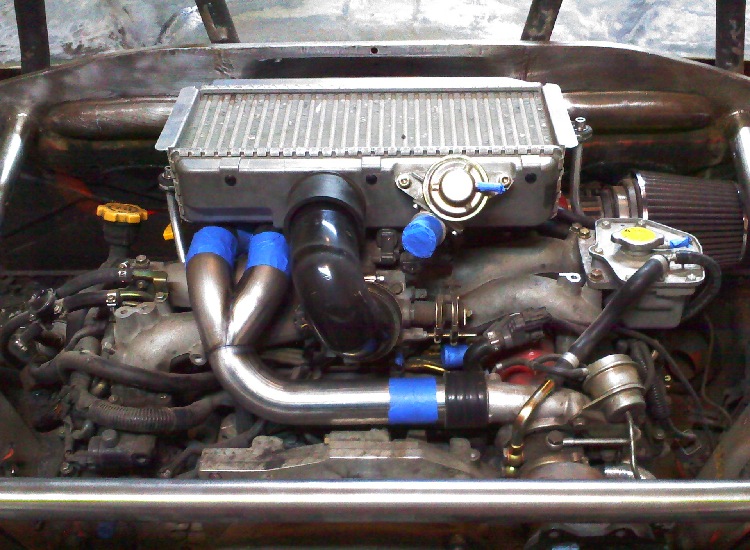

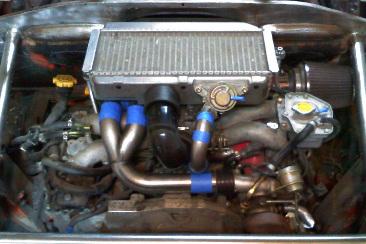

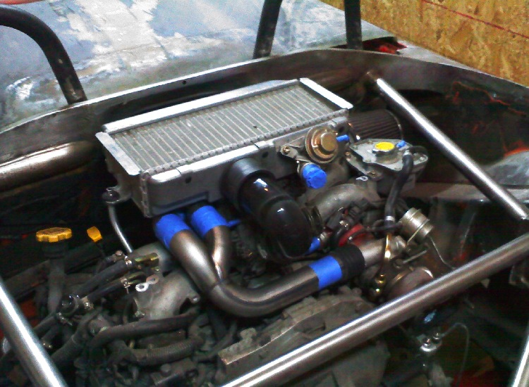

I drove down to Littleton, CO this morning and picked up some 2" mandrel u-bends. I then pieced together the intercooler intake tubes. They are only held together with tape now because I still haven't figured out my welder situation. I only have 110 at my place and my 220 welders are up at my in-laws place in Cheyenne. I may have to make some time for welding when I go up there for thanksgiving. Some day I would love to swap these out for aluminum but that is more trouble then it is worth right now, I still managed to drop 4 pounds because this plumbing system is much shorter than the previous version. That brings the total up to around 414 pounds shed. Sorry for the fuzzy pics, my camera couldn't figure out all of the shiny tubing.

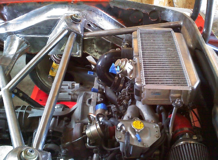

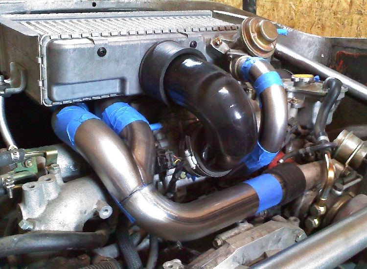

Last night I mocked up the blowoff valve tubing. Other than welding these pieces up the intake system is fairly complete. I think I will have these three tubes painted body color.

QUOTE(plymouth37 @ Nov 16 2009, 09:21 AM)
They already are!
Glad to see you back on this Dana. We all look forward to the next episode. I hope I get to see this thing in person some day.

Crazyhippy
Nov 16 2009, 01:42 PM
Looking good Dana...
Just a heads up, the MAF might need to be clocked slightly to get a pure reading. Ran into an issue on an 05 stang w/ a vortech. Some places it would read very erratically based on RPM, and just twisting it around really cleaned up the signal.
