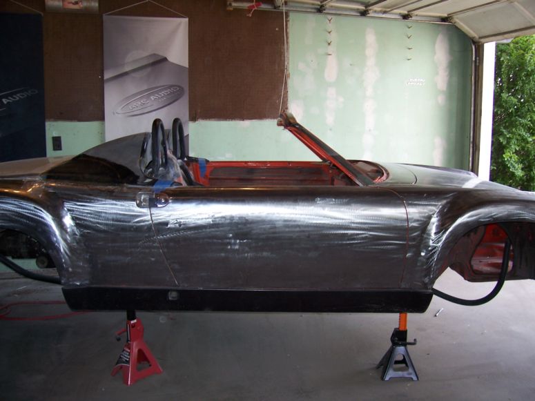

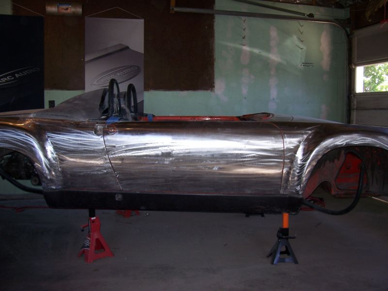

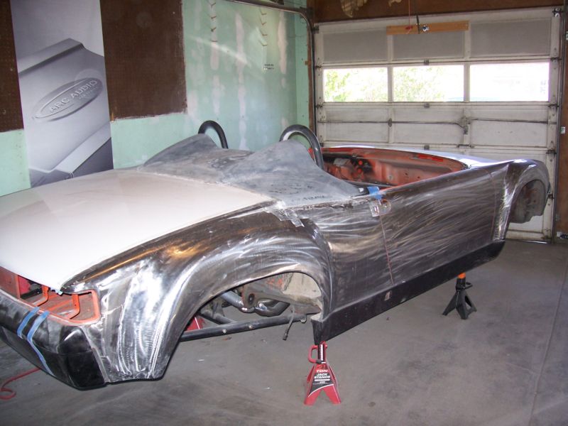

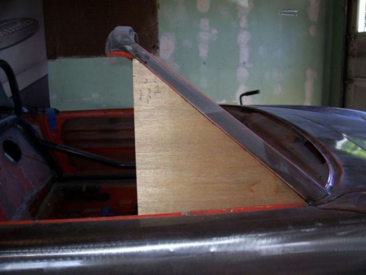

Today I made a wood template to ensure that I install the windshield at the right angle after I chop it.
Then I cut the thing off so I can modify it. Looks pretty cool huh?
I also test fitted my Getty F/G bumpers, they will need a little work but are pretty close.
It is so tempting to just toss the windshield all together.
Nothing like having to wear a helmet to go for a drive! (for some reason I don't think the wife would approve. biggrin.gif )

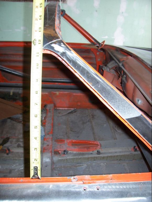

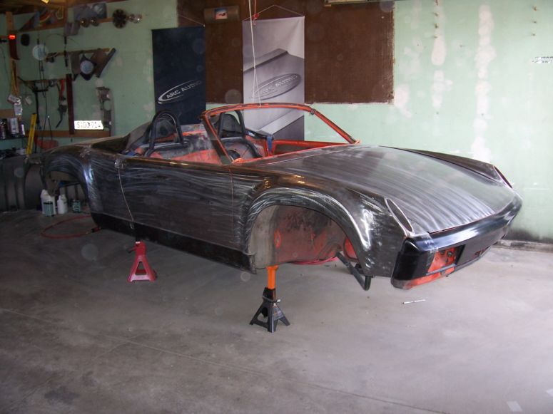

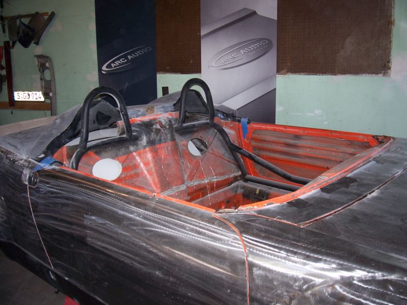

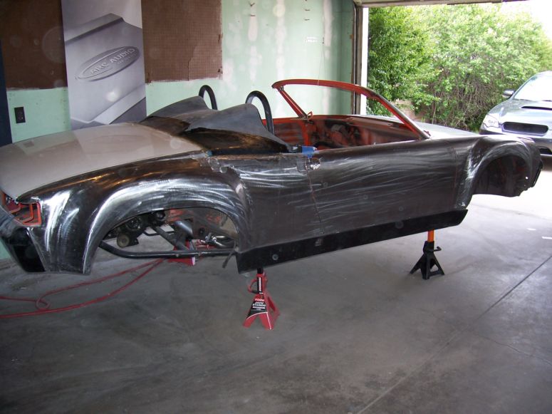

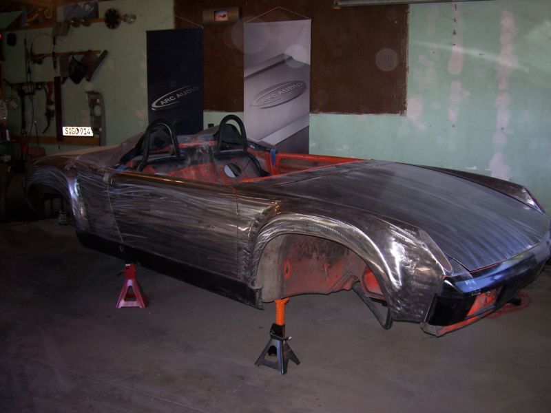

My dogs decided to wake me up at 4:45 and I couldn't get back to sleep so I got an early start on the car today dry.gif
I added a layer of 'glass to the humps.
I chopped the windshield frame and mocked it up on the car.
I need to do a little welding and cleanup to the frame such as rounding the top edge and corners before I install it for good.
How funny is this, the car is on 18" jackstands and it's still lower than my Subie! laugh.gif

I filled in the headlight holes on a stock hood but I am swapping this one out for a lightweight F/G one.
Low enough? biggrin.gif As you can see I needed to make relief cuts in the top corners to be able to spread the pillers to fit the cowl.

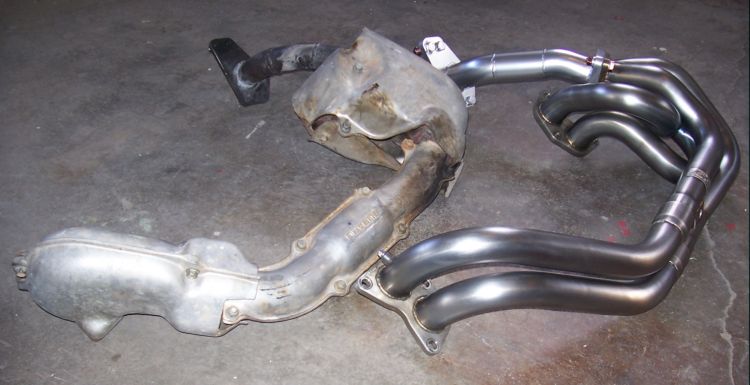

I am using a stock turbo. I ran with a group of subie guys in vegas and with out fail every time someone would upgrade their turbo they would regret it, oiling issues, lag, overheating etc... Subaru put a good turbo on this engine and I intend to keep it.
You know...... you could go with a slightly used VF39 (Stock STI turbo), and a set of Subaru "blue" 06-07 555cc injectors (Stock 06-07 WRX injectors).... and still be 100% OEM Subaru parts....... and probably put down another 100-125 horsepower..... safely and reliably
You're always gonna have guys with oiling problems, tuning problems, backfiring, and all sorts of other crap. Without fail, every time I hear about guys having problems like that...... they've done something wrong, or cut corners that they shouldn't have.
It's just a suggestion..... I went that route... and just crossed over 30K miles... with zero problems whatsoever.

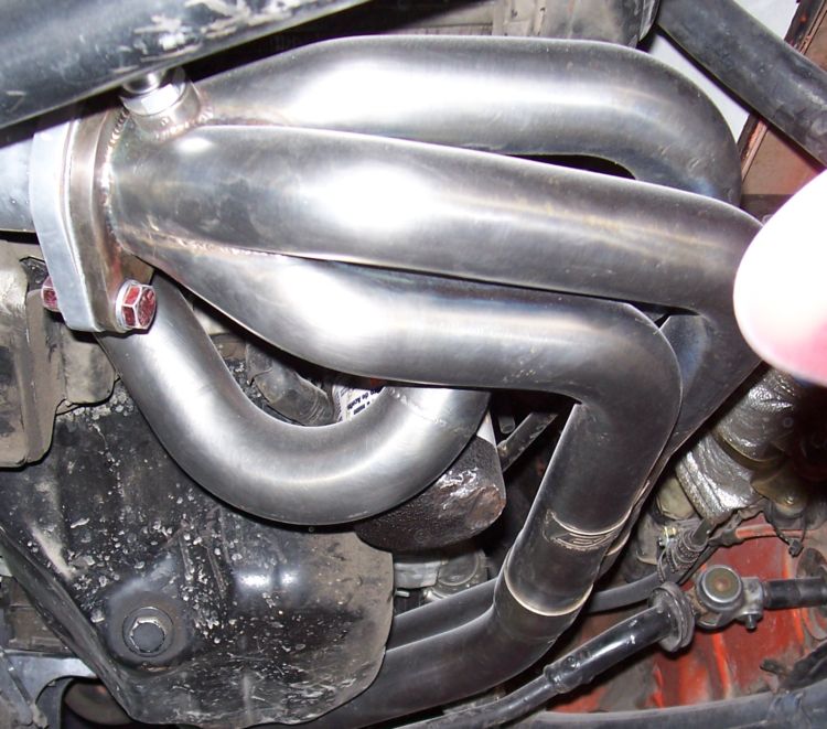

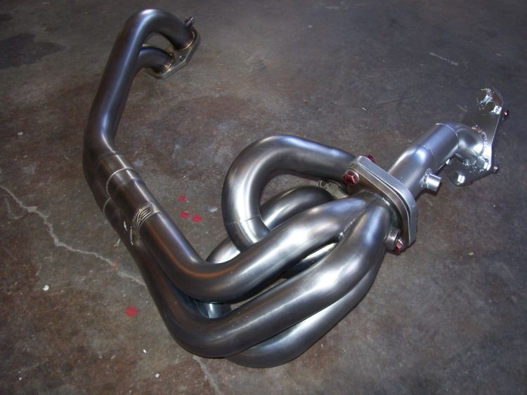

plymouth37
So I finished my other project for the day, say hello to 5 gallons of sweet cherry chocolate stout! Give it about a month and it will be perfect. beerchug.gif
Check out the stainless steel DC sports header I installed along with a custom up-pipe I built. Purty aint it?
It frees up some horses and is 12.2 pounds lighter than the stock manifold biggrin.gif
ericread
QUOTE(plymouth37 @ Jun 12 2008, 06:57 PM) *
First: The pipes are awesome - belongs in the Gugenheim (that's a museum for you gearheads out there).

And yes, the header is a work of art, DC makes some nice stuff.
