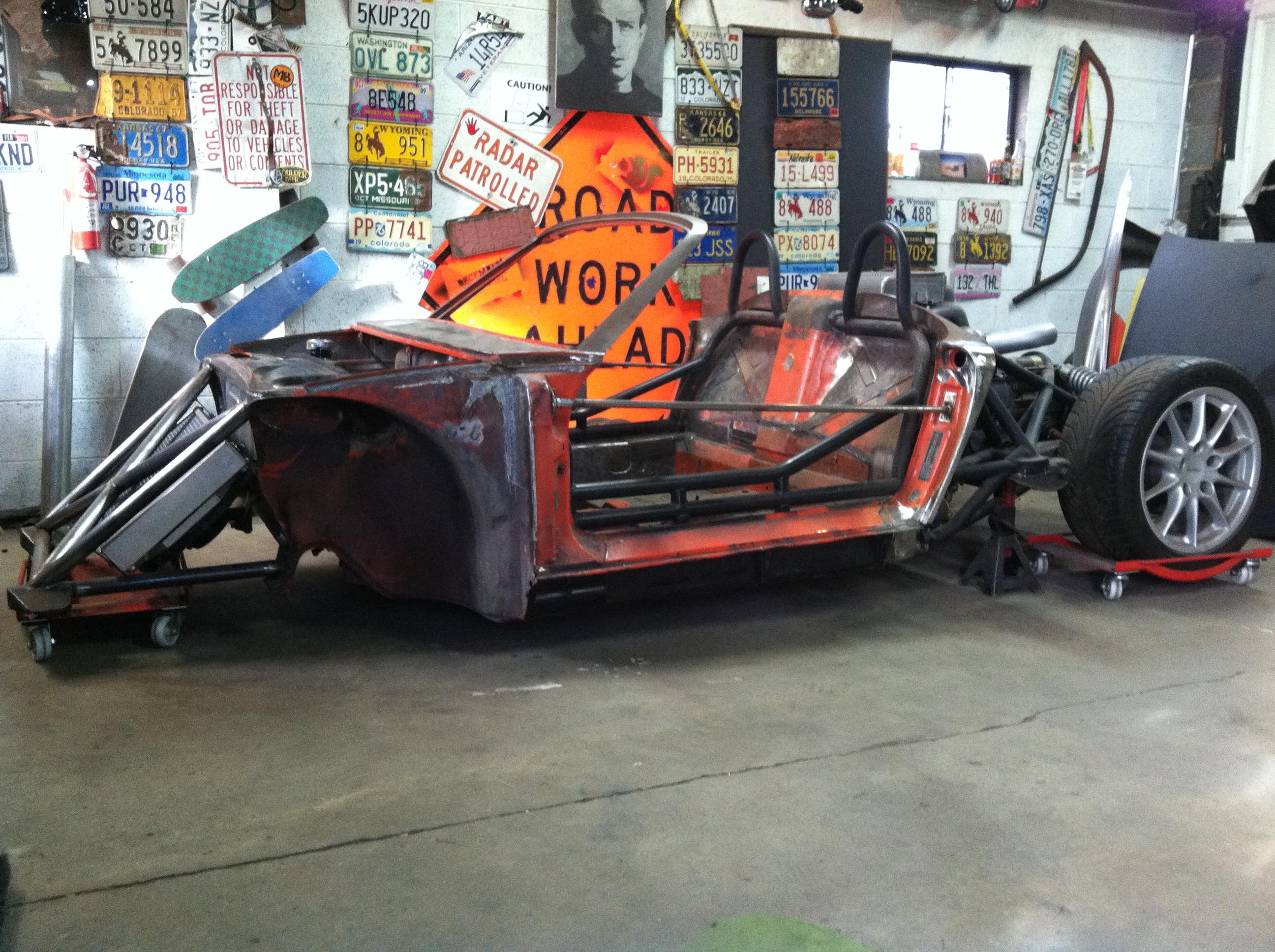

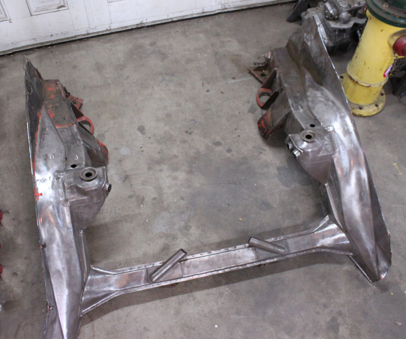

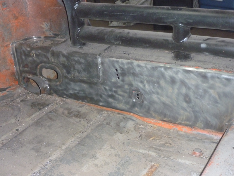

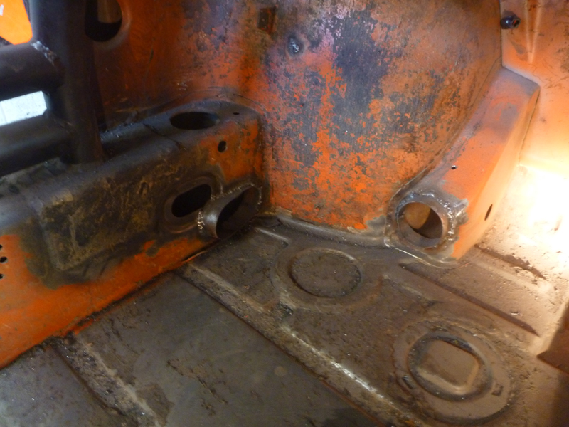

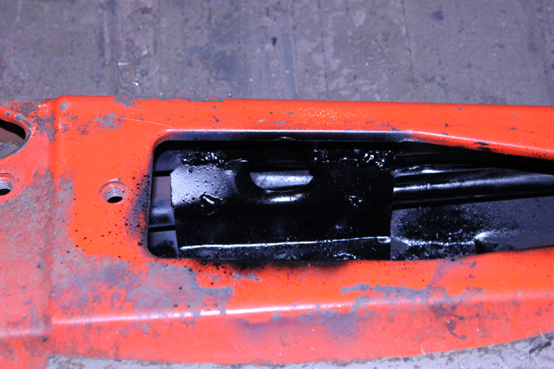

No fun work today, just cleaning up the tub in preparation for paint, I want to fill every unused hole in the tub before it gets sprayed.
Since I had to tunnel through this part of the long for the coolant hoses I figured it would be good to add some metal back into this area.
Since I was working in the area I decided to cleanup and patch any holes in the longs I had created when I removed the heater ducting.
Everything is welded, it is reassuring to find it harder and harder to find projects to do before the chassis is ready to paint!

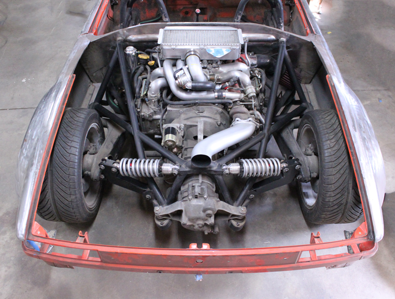

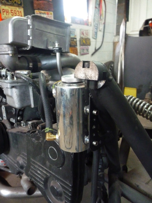

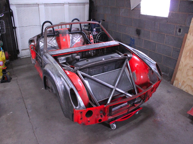

I got a little time today to pretty much wrap up the rear portion of the car.

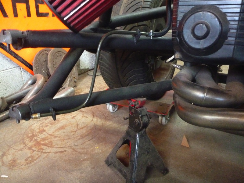

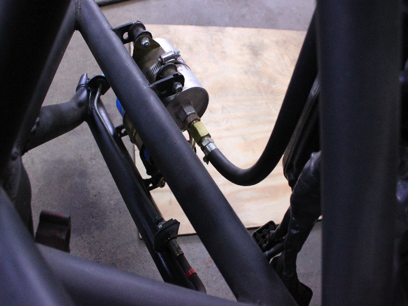

I started off by bending and mounting the fuel return line.

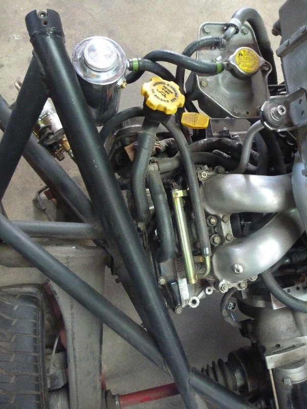

Then I made the bracket for the coolant overflow tank.
I bought a "WeaponR" aluminum import tank, cheap and reasonable build quality.

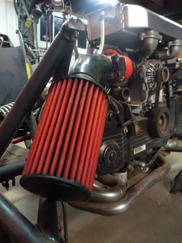

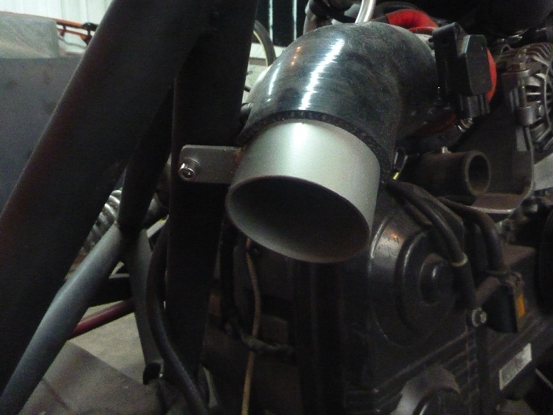

Finally I made a mount for the intake system, I welded a bung into the tubeframe and tied the airfilter adapter into that.
Phil Plummer
That is without question the most atractive & tastefulll departure from the 914 style I have ever seen!!
Well now that I have started a 916 look alike I want this look .
Many an afternoon has been spent looking at the rear of the 914 and 914/6 and wondering as I would doodle a fast back or slope or just think "what is this car missing?" was the question in my mind -You have the answer & wowthat is agood answer!! what would it cost to duplicate thismost attractice creation you Fu*@#$% Brilliant .This is way @#$%*&!! COOL!

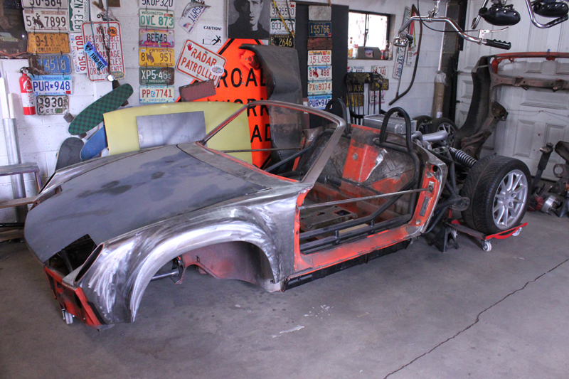

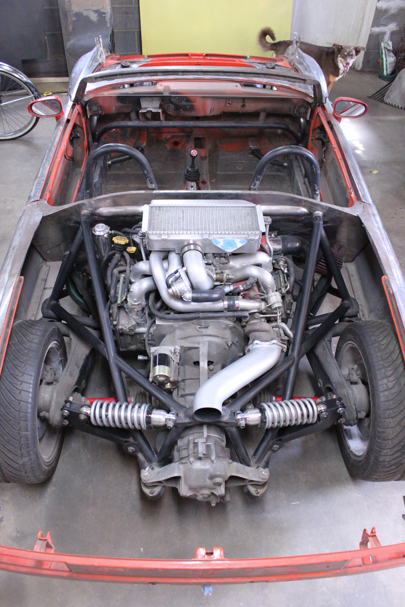

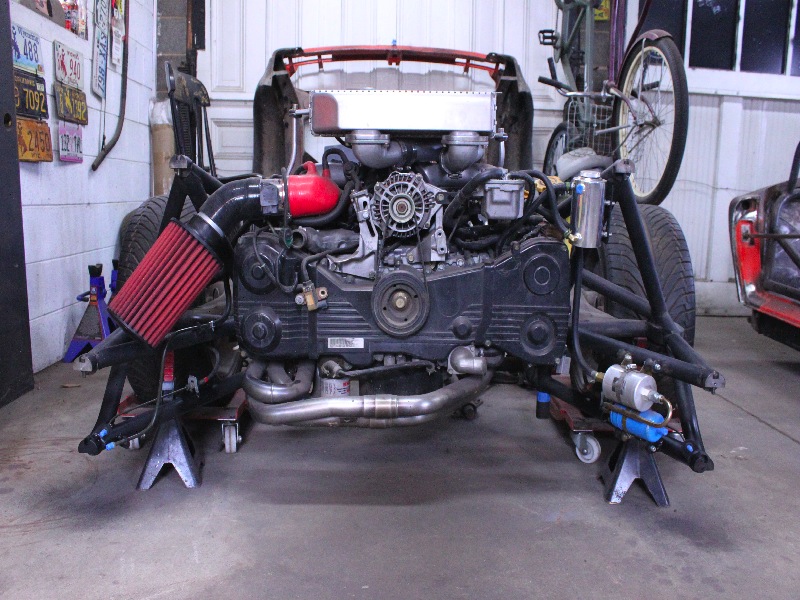

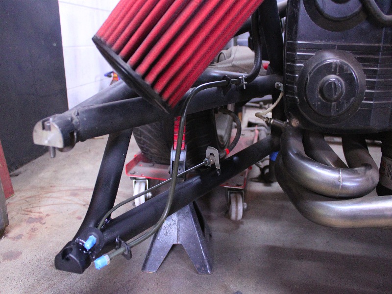

Last weekend I finished the rear portion of the brake lines.

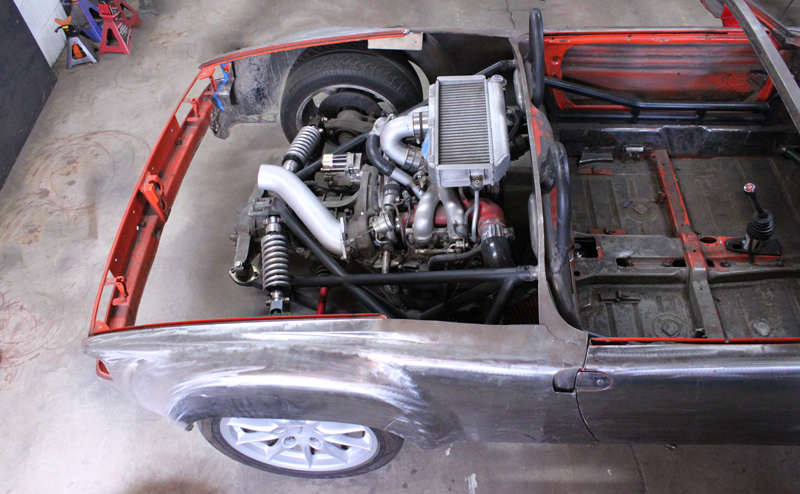

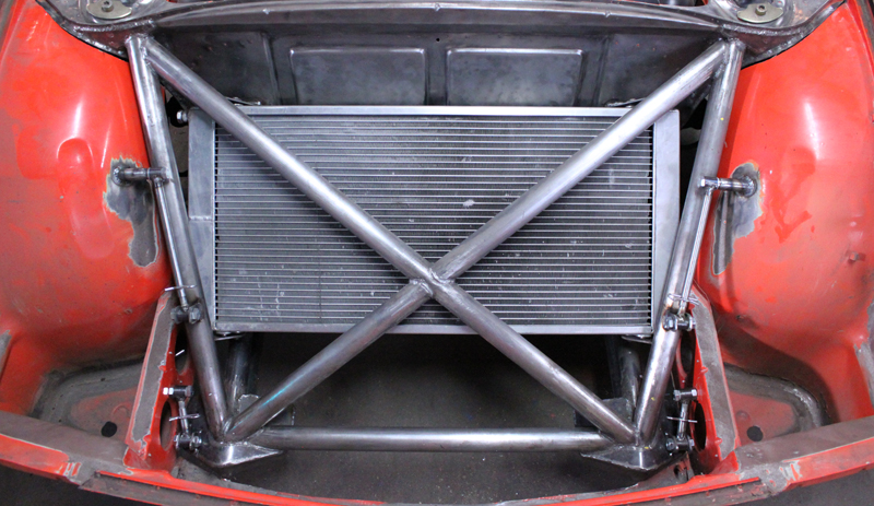

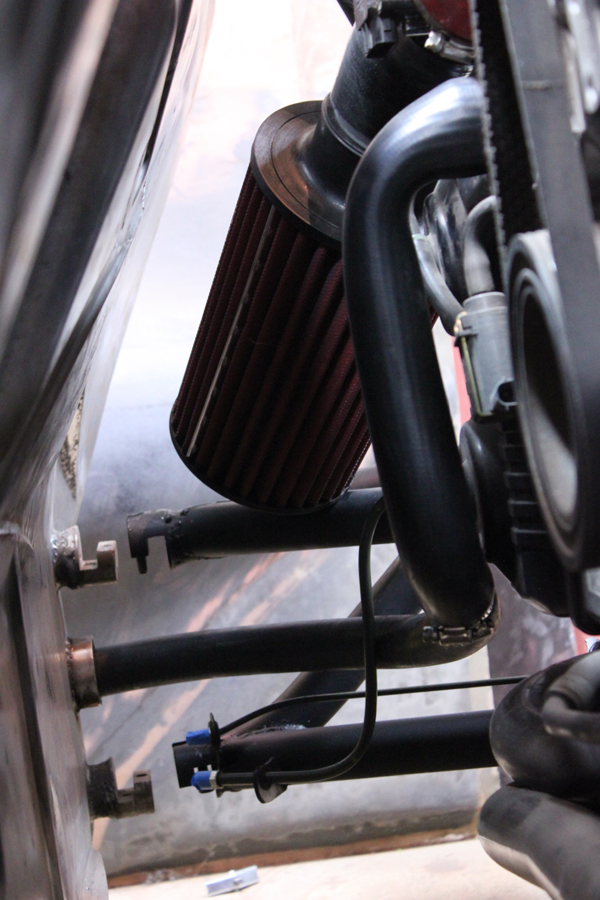

Here is a look at the front of the engine.

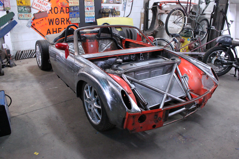

I also started fitting the nose to the chassis.
It is an almost perfect fit, I will be welding up the tilt nose soon!

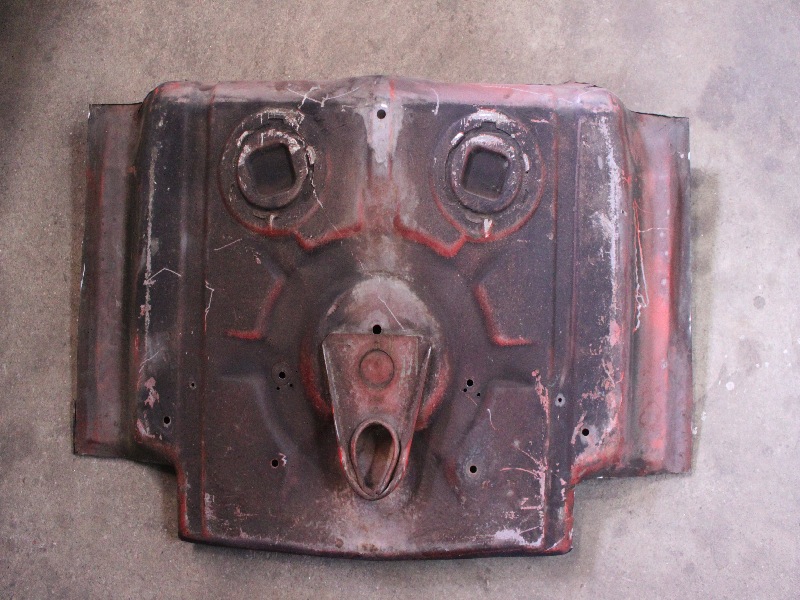

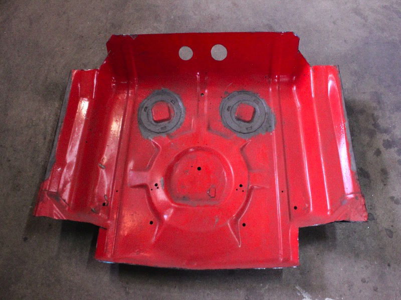

If anyone needs to repair an A/C hole this is yours for the cost of shipping! (Sold!)

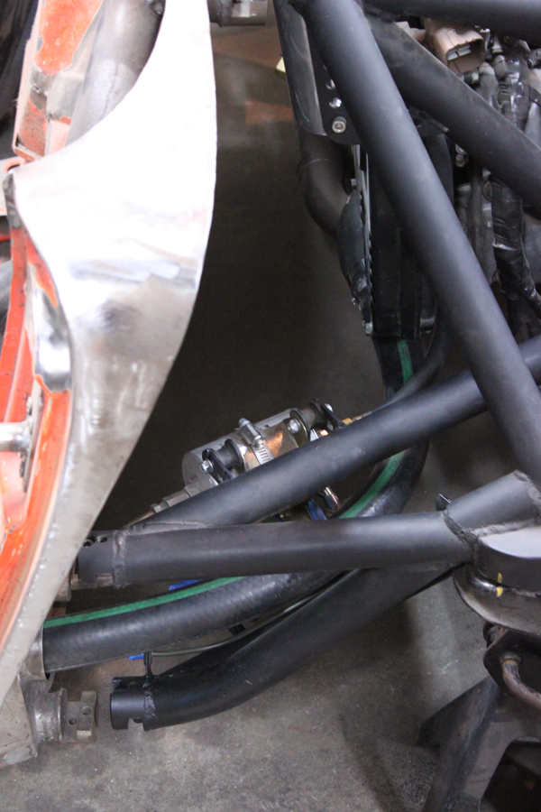

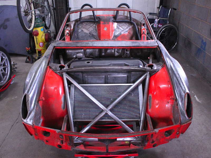

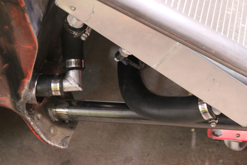

I finished hooking up the coolant hoses, it took a 1991 Nissan Sentra hose, half a 2001 Suburban hose and an un-identified hose I found at AutoZone to get everything connected. I am almost done hooking up all of the connections needed for the car to run. Both coolant hoses will be heat wrapped to keep heat from effecting the fuel system once I get to final assembly. Once I am done with the mechanicals I will pull the chassis apart and go into paint.

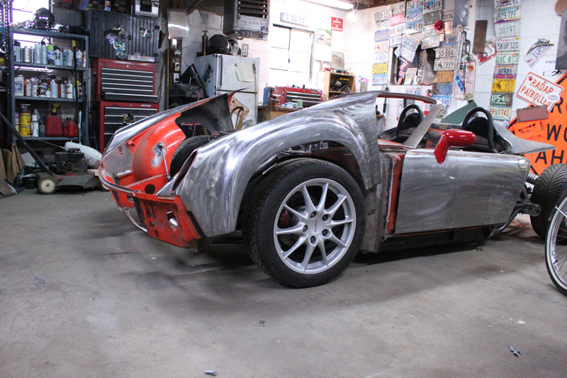

I also worked on fitting the pieces of the front nose.

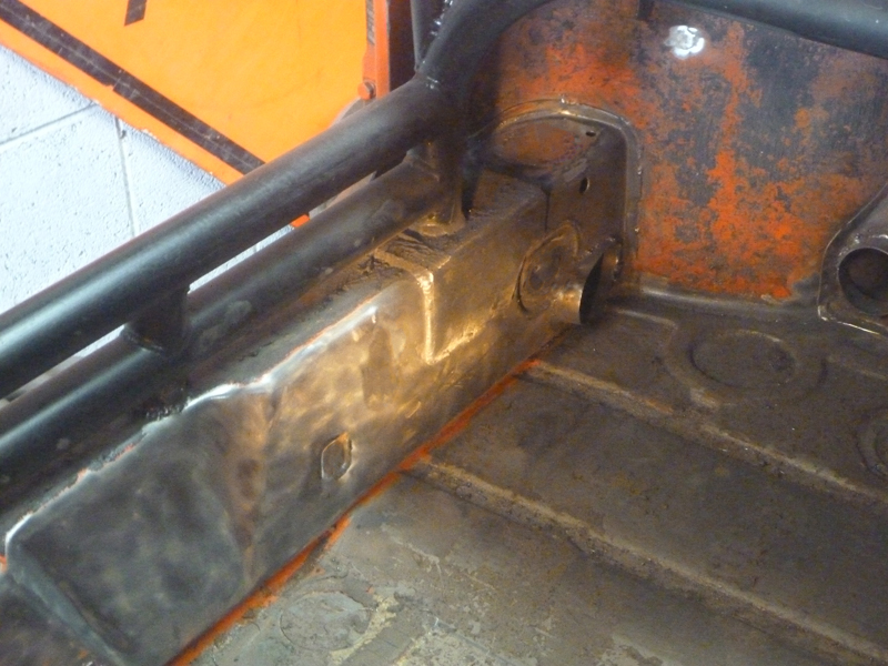

I got a little bit of work done last weekend, I am trying to finish up the handful of welding jobs left on the tub.

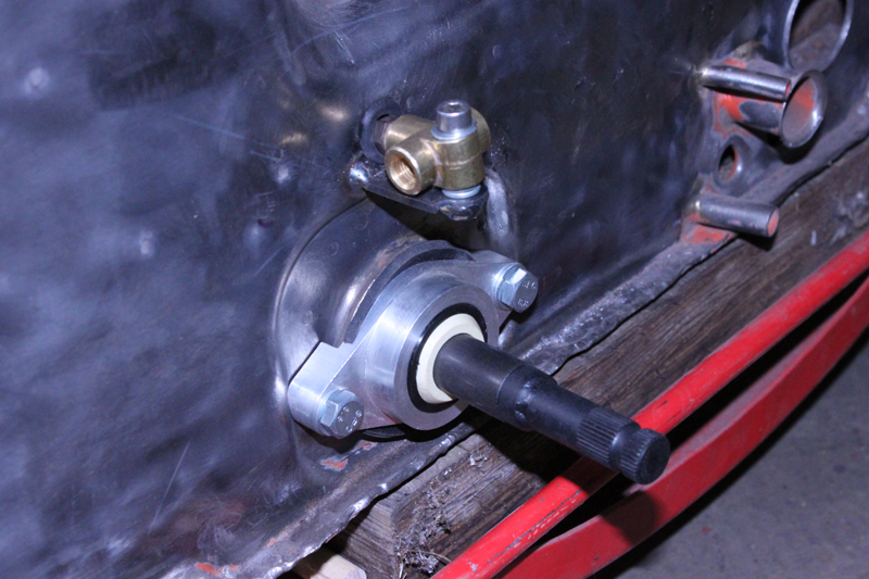

I focused my efforts on the tunnel, I started by bracing the clutch tube.
There wasn't anything wrong with it but it is the kind of job you have to do if you have the shifter out and the welder handy.

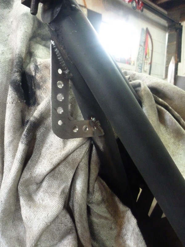

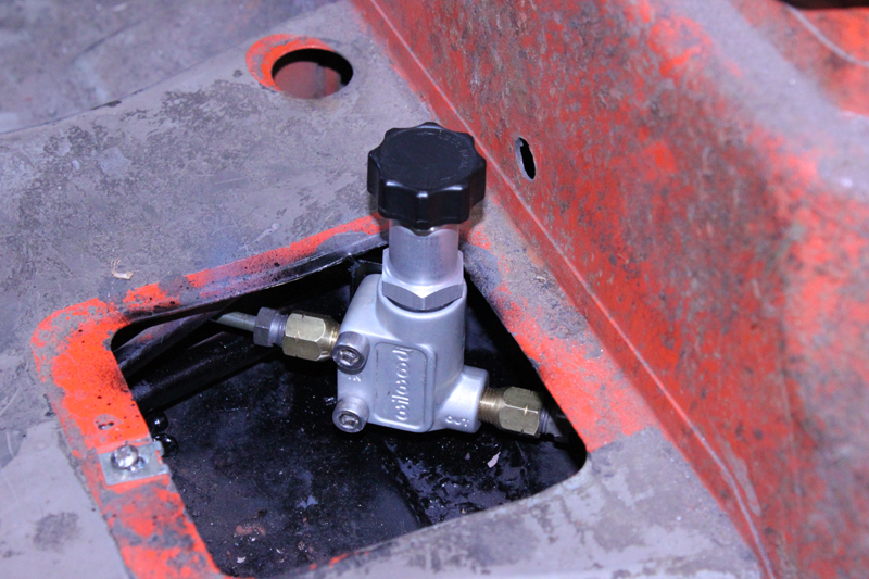

Next I welded in a bracket to hold the Wilwood brake proportioning valve I bought from JWest.
I figure a little adjustability in the brake bias will probably be nice once the test driving portion of the build comes around.
It will also make dialing in future brake upgrades a snap.

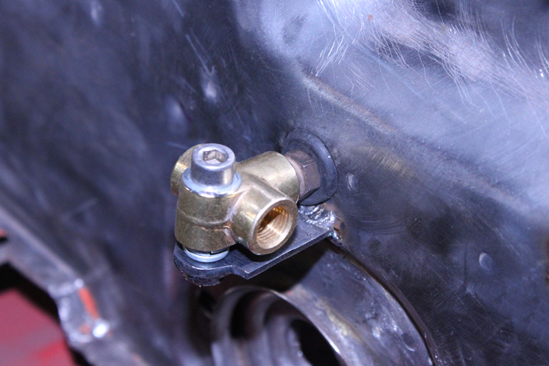

Finally I mounted the JWest brake tee to the firewall with a little bracket, making it possible to eliminate the stock brake regulating unit.

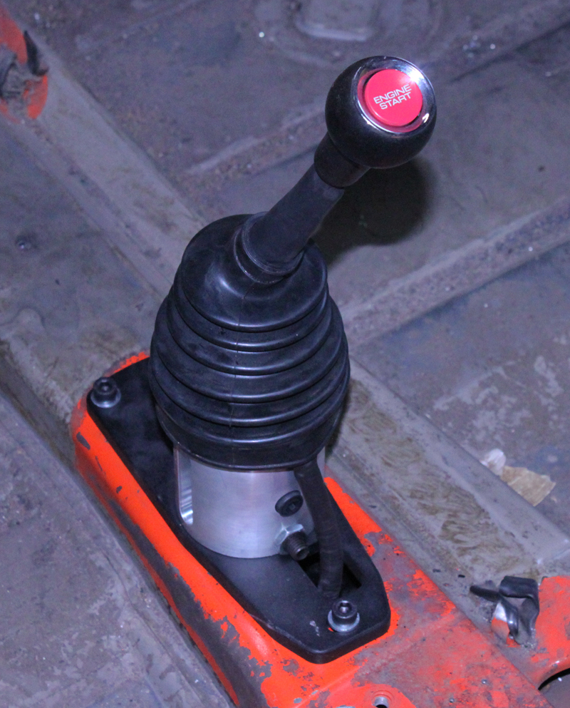

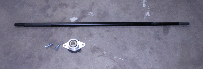

I cut the stock shifter end off of the original shift linkage then welded it to the JWest shift rod.
Then I mocked up the shift rod bushing on the firewall.

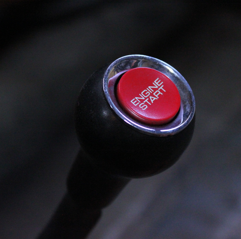

Next I mounted the Rennshift shifter with a custom shift knob I rigged up.
My stock shift knob was in really rough shape so I mounted the starter button from a Honda S2000 into it.
The button will be functional and the lettering lights up when it is armed.

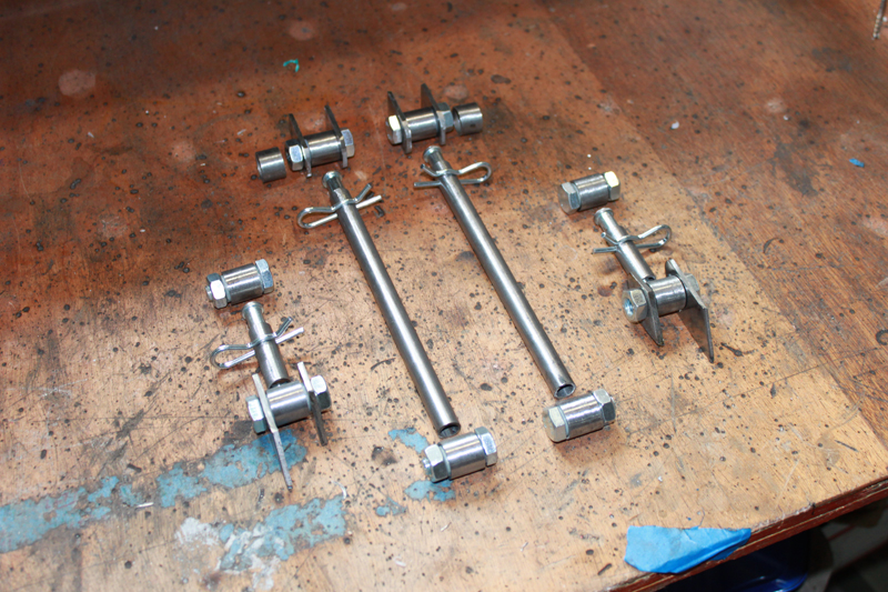

I did manage to design a hinge system that allows the nose to clear the doors as it opens though.
Here is an illustration of how it will operate. Hopefully I can get it built this weekend.

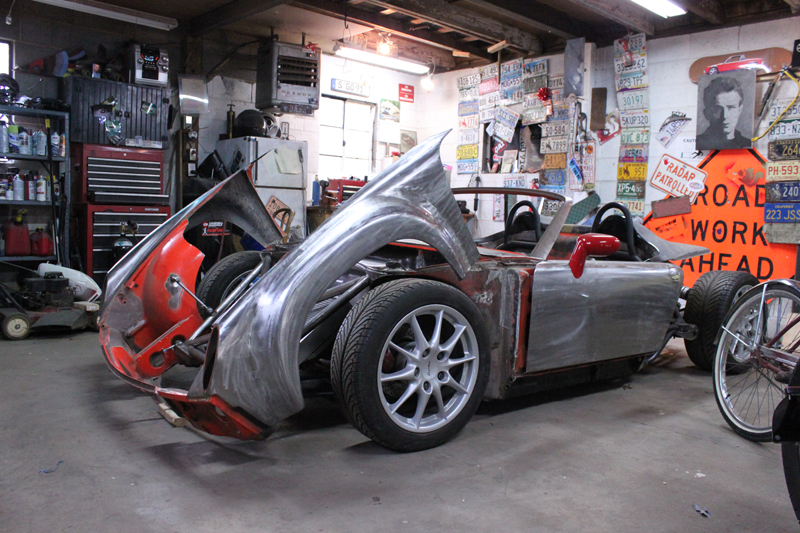

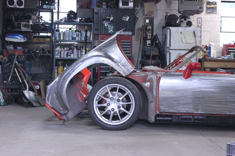

I got the major elements of the nose hinge done today.
I started out by fabricating the components needed to build the hinges I designed last weekend. I used nylon spacers to serve as a bearing, I also drilled out the centers of them to adapt the standard tubing to the metric hardware. The cotter pins allow the entire nose to be removed in a couple minutes at most.
Here is a shot of the nose closed, notice the perfect door gap, my biggest concern with this project was properly aligning the nose and I think I pulled it off.
Here is the hinge system with the nose closed, I will be adding hydraulic struts to the system next. Ultimately you will never see this view because the hood will be welded to the fenders.
The nose partially open.
The nose fully open.

plymouth37
I did a ton of cutting and freed the rear fenders from the old frame rails. If anybody wants a fairly rust free chassis half let me know, you can have it as long as you pick it up.
It is shocking how much this weighs.
I started fitting the rear portion of the body to the car. it is really surprising to see how much open space I have back here!
Now that the rear portion of the body is mocked up the next task is to make the hinges to tilt it open.
It will be hinged from the back offering excellent access to the drivetrain, the lid will be welded to the fenders just like the front.
