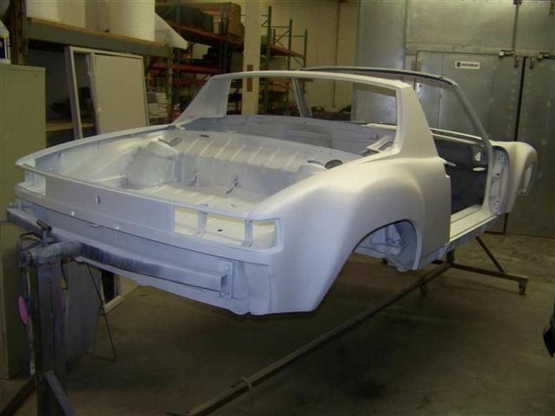

Lets see if your still in.... My question is..... I have my steel flairs installed now (and they're from you). I've left the edge that turns in toward the tire the same size as I received it. Its about 1/2" or so. Jon of Everett Wa has suggested I trom them off at the top to allow for the tires. Today I studied a completed car and they had actually rolled the top of the flairs inside all the way. The guy was running 9" in the back and 7" in the front. I not sure yet, but I was planning on running 8" & 7".
Do I need to trim or roll. I already have the body ready for paint> I'm working on the 600 grit at this point and am afraid of screwing up my work. But it would be so much smarter to do it now than after painting.
What's your opinion?

Click to view attachmentMy concern is the lip that may rub the tire at the top of the flair.

really will depend upon your choice of rubber/wheels and spacing.
If you have the wheels, mount them up.
If you have any intention of putting wheels that will fill it up...roll it now.
Its alot easier to fix now then after the paint.
Cover the outer fender with two or three layers of masking tape.
Use a hardwood dolly and a wooden hammer with a big face.
The wood will condiserably reduce the stretching of the metal and with a big hammer face and a big dolly you will also reduce the pinpoint damage of a smaller hammer.
It will take longer, but if done right, no body work, or very little after your done. The tape will also cushion the blow...
Just trying to keep you from having to sand all over again...but you may need to flat sand it with a long board/guide coat to be sure its straight.
The other option...take a die grinder and cut the lip off so its really small...1/8 inch...
Rich

roll it ... you should be able to do so without messing up your prep work ...

I don't have the wheels yet so I guess it's better to allow for the most clearance. I'm thinking that I'd rather cut the lip off than roll the metal and mess up all my work.

I always get the rims and spacers on and all lined up as I am installing fenders. The 914 is know to have a big differences from the left to the right. If you do it this way you are sure to make the gaps equal. but make sure you add the weight of the trans and the Eng, so the car sits as it would on the ground. Also try and set the camber as that affects the rear a lot in cornering.
If your not able to go at it this way get a friends car up in the air and grab a measuring tape and get it as close as you can with the rims you plan on using.
And finally keep in mind you can only look at one side of the car at a time so 100% equal is not really needed.

I've got a friend who knows how to do body work. Last week he finished up a 59 Lister that's up for sale $750,000!!! I'll get him to come over and give me a hand. Rolling over is going to give me a stronger edge.
Hell I didn't want to paint the car yet anyways.
