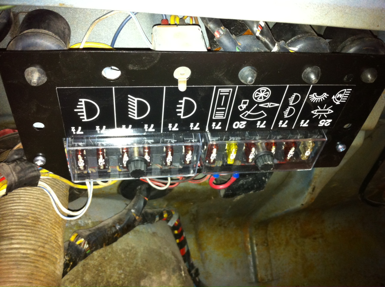

Jan 7 2012, 01:27 PM
I purchased this fuse box a while ago and just got around to installing it. Super simple.
3d914
Jan 7 2012, 05:38 PM
Thanks for the photo Harpo. Do I see three extra holes for relays (one on top & on each side)? Mine is to be customized for V6.
