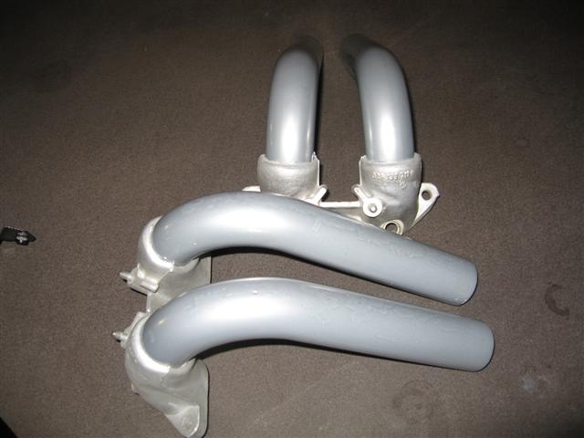

Click to view attachmentSears sells a neat powder coating gun,, http://www.sears.com/shc/s/p_10153_12605_0...00P?vName=Tools. I bought one an did all the tin of the engine that I rebuilt. Check my blog for some pictures. I you have an oven like a stove oven you can fit all your tin into the oven with no problems. I just finished up doing some pieces that I'm going to use on my next engine which I will start to build in the next to weeks. Powder coating is easy, the hard part if the prep work on the pieces that you want to coat.
Heres some pics of some pieces that I did this afternoon:

those are beautiful. did you use a gas oven?
