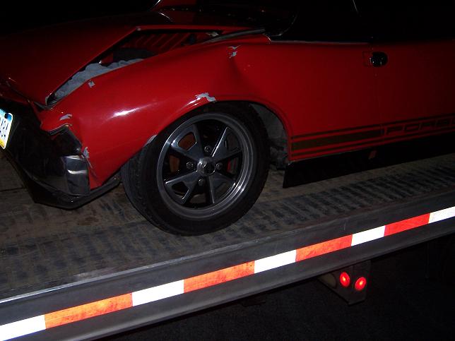

When I was deciding if my son could have a 914 I searched many threads and looked at alot of totaled 914's
The Insurance companies are just right when it comes to boys, under age 24....they are the highest risk group.
I have three male drivers...all had accidents so far.
In stock form, with a spare tire, these cars can take a serious hit and the doors still open.

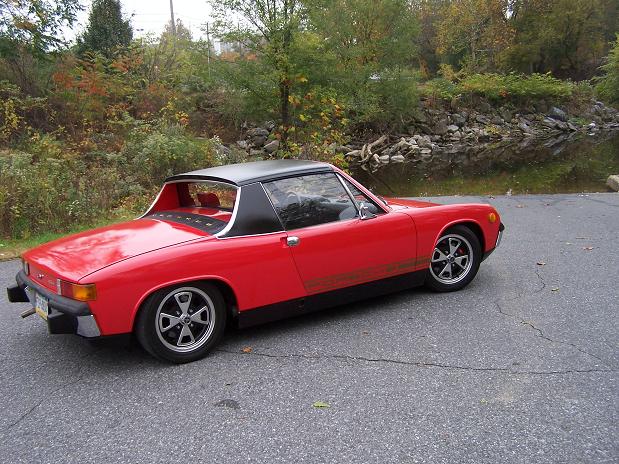

My son did finally rear end a car with his 914 after driving it for a few years. It dented the bumper, headlight and inner fender buckled (its a 74)
The crash zone stuff in these little cars does work..
I pulled and stretched it all back out again.
Oh, ugly though they may be, the tits focus the crash in exactly the right place.
