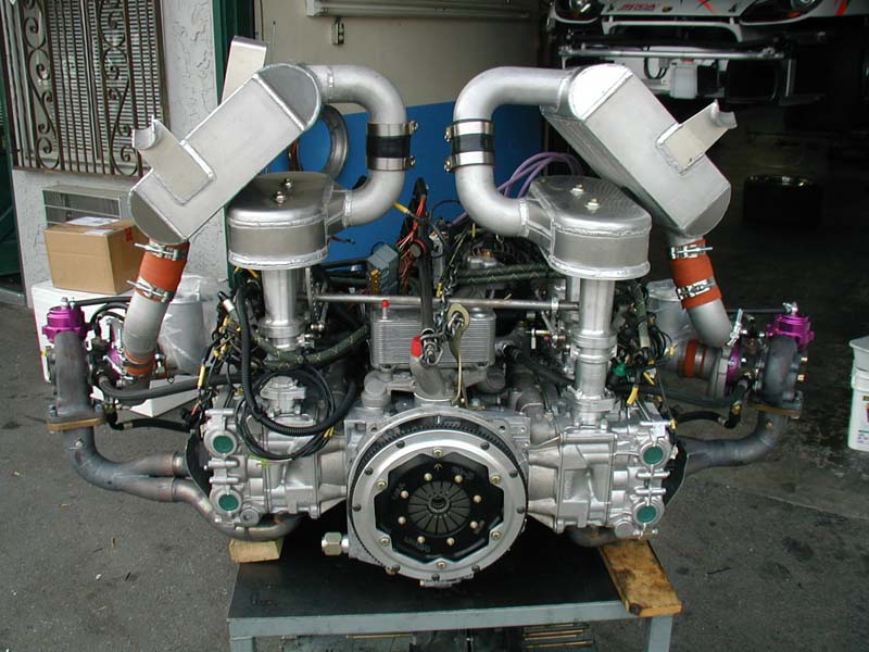

What is that supposed to fit into? Will that cram into a 911 bay? It would be way to tall for a 914. I've never seen a stock TT, so that may just be how they look. Dunno.

Wow, what is that, some dune buggy engine? Cool !! I'd love to see that in a 914...would it even fit?
Zach

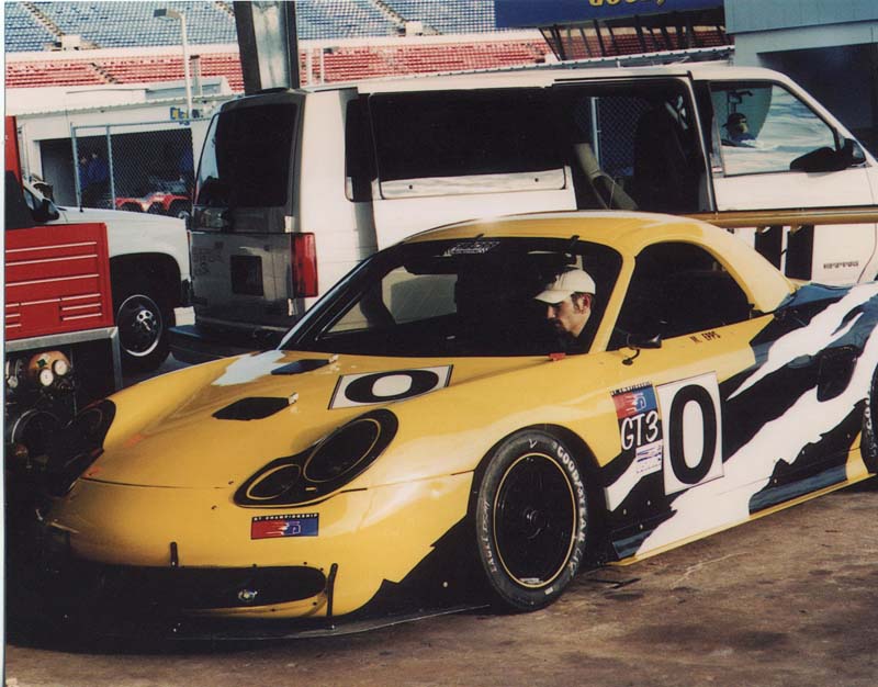

Twin turbo 700hp. This motor is in a fabcar tubeframe boxster. The car is for sale on PCA.org.
r_towle
Turbos would hit the suspension ears, so you would need all new muffler setup.
Intercoolers would also not fit...but its just plumbing...go for it!!!!

The engine has coil-on-plug so the lavender wires must be for something besides plugs. There are some differences I see in the case on this one compared to my Boxster S case, so I think it is built on a 996 but they are very similiar.
That being said, it is not just a matter of plumbing since the engine is too wide, with the coil-on-plug hitting the suspension ear. Ask me how I know sawzall-smiley.gif welder.gif See pic below.
The intercoolers are gonna be way too high also but you would need them in cool air anyway so sticking out of the engine bay may work biggrin.gif
It would be crazy tight trying to make all the turbo stuff fit under the car in a 914, but it would be FUN. Maybe a single turbo with a water to air intercooler idea.gif
Thanks for posting the pic, that is not something you don't see everyday......unless you have $175k laugh.gif
