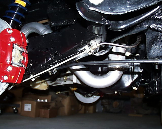

Mine are under the axles. If you hug the transaxle there is no interference when you jack the car up and let the suspension hang.
Here's mine as I install it. Notice my exhaust cross over through the muffler. smile.gif

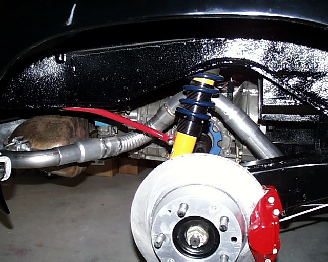

Phoenix-MN
Just an update on what I did. I fabbed the pipes up to go over the axles.. Now that I have these I'll take them to HearthThrob Exhaust and have the final ones mandrel bent out of stainless steel.
