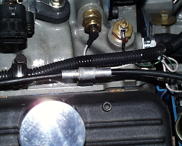

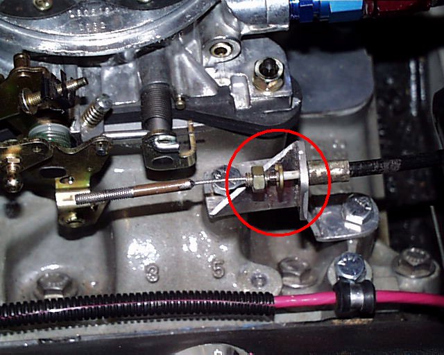

I was finishing up my throttle linkage this morning when this went snap
I made a custom length cable from two stock cable sheaths and some SS cable. Anyone have a stock cable sheath (or Terry Cable sheath) laying around? (I don't need the inner cable).

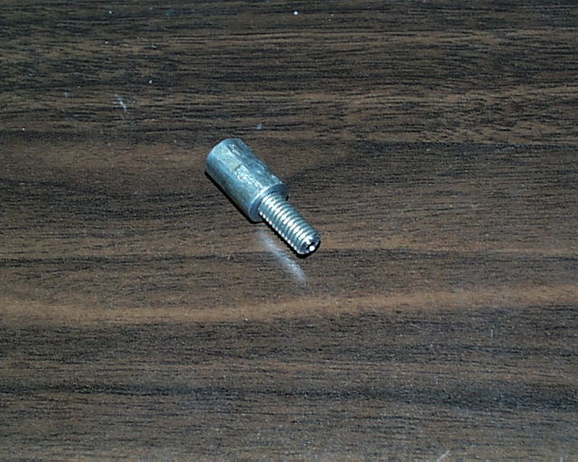

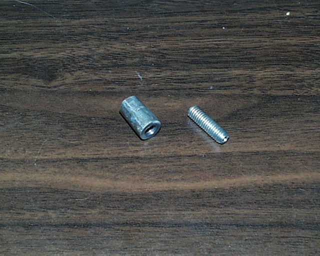

Well the loacal motorsports store didn't have too much and nothing that would work. Started burning some brain smoke.gif cells and decided that I could drill out the cable end fitting, tap it for 6mm bolt and then take a 6mm stud and center drill it for the cable. Then I'll silver solder the stud to keep it from un-threading. Now I can start stepping forwards again biggrin.gif
