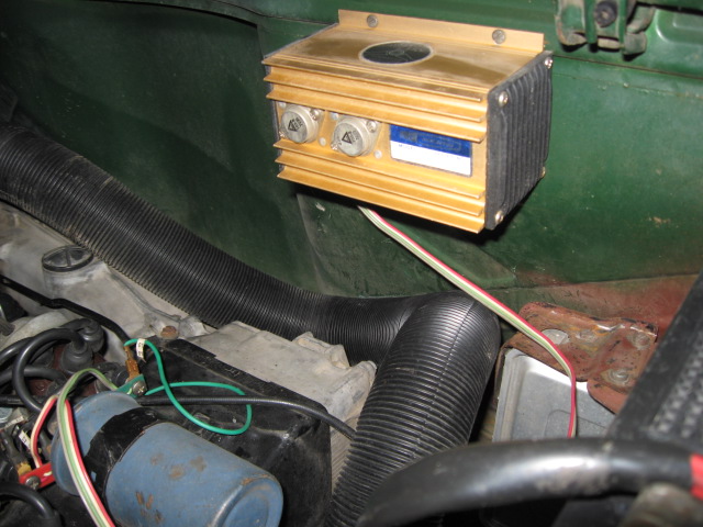

I posted last fall about my problem: '70 D-jet, extremely hard to start, requires much throttle goosing to keep it going. Once it is fully warmed up it runs great.
I assumed FI problem and have checked everything. All seems OK. Bleysing and others suggested weak spark. Good enough for warm engine, but inadequate for cold. (Frankly, ignition is the weakest category in my 914 skillset). I have checked all connections, grounds etc. All seem OK.
Then, a light bulb! My car has a Heathkit, vintage capacitive discharge ignition (I have no clue how it works or what it does, see skillset deficiiency above). I do know it is over 30 years old. Could that be my problem? Can I just disconnect the 4-wire harness from the coil? Or do I need to do some other re-connecting.

I've got a Heathkit dwell meter and AFR meter. If your thinking weak spark that would be the first place I'd look. That coil looks like it has some years on it too.
The coil is a transformer. It takes 12 volts and turns it into thousands of volts. It does this through windings and inductance. It appears that the heathkit is hooked to the positive and negative side of your coil. I'm assuming that it's supposed to ensure you get max voltage to your coil. If it's bad your coil might not be seeing 12 volts.

I have done a thorough "Brad Anders" FI check and have replaced the head temp sensor (old one was ok but did it anyway). Replaced the points also. Didn't help at all. I did not replace the condensor but I think that is a "go-no go" item. I guess it won't hurt to eliminate the CD box and see what happens. I suppose the ECU could not be doing its thing when the engine is cold but I'm told those are the last place to look for a problem.

I checked Anders chart and I have the original engine and correct ECU. I haven't checked MPS # to make sure it is compatible, but the car runs near perfect when warmed up. It is a one-owner 105K car so is very original in all respects. Previous owner said he installed the CD in the early '70's as it was supposed to provide a hotter spark.

Well damn, I disconnected the CD.......no change. I then decided to buy a new coil (if you can't fix it, throw money at it!). Again, no change.
