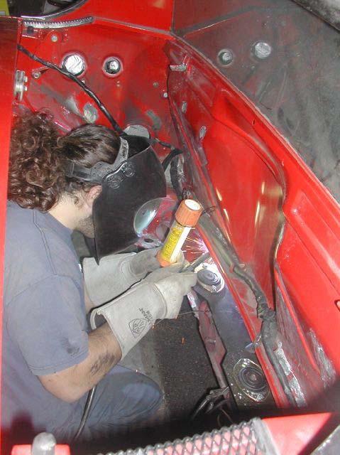

McMark doing his Magick:

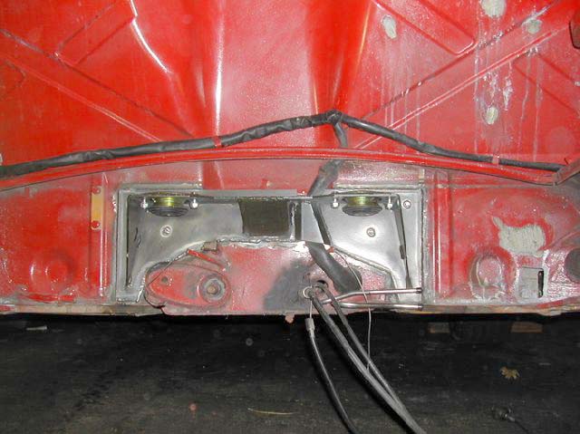

Click to view attachmentSeam-welded all around, even filled in the "bolt" holes:

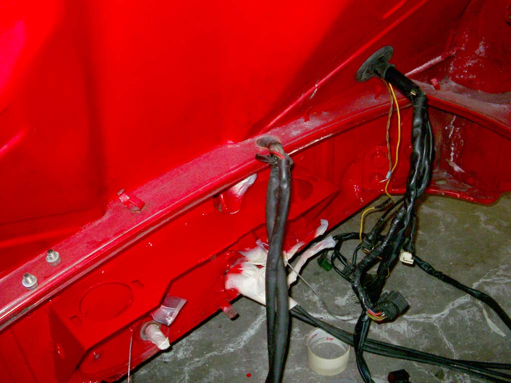

Click to view attachmentAnd some touch-up paint:
