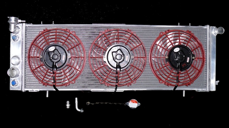

no flames please , but I still keep looking at the "extra room infront from the short ej20 layout and have the radiator in the engine compartment.. I found an AL three fan cherokee radiator.. 36 in across and and 13in high...Sit it low and use the natural air flow from bottom to top...
Click to view attachmentand I know a friend of mine keeps saying "radiators belong in front of the car"

He is also using 1.750 and 1.50 id lines I think. The stock suby id is 1.25 or a little less.
