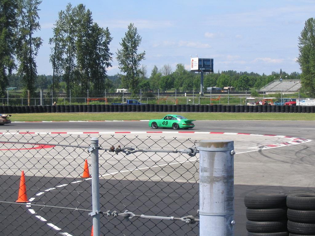

Toyo Spec 911 race car, GTS class with PRC, SP911 class with PCA.
No Street, no AX, just *big* track ... 3.0L with aftermarket FI. About ~270 HP at the rear wheels. 245 x 16 Toyo RA1 tires in the rear.
shades.gif Andy

Portland is one of my favorite tracks . driving.gif ....I love that track

I like the color.
