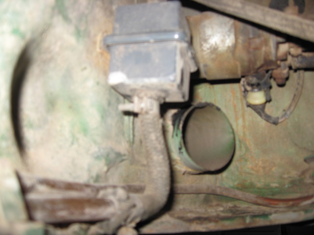

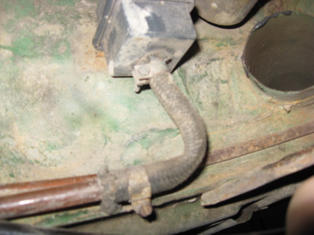

Since I am continuing to beat this horse...........
I took some pics. Now that I look at the inlet hose more closely, it appears I have a tapered hose leading to the filter! I think my focus has been on the end clamped to the plastic line! Appears my replacement "cube" will "bolt up".
Hope my ignorance results in someone other than me benefitting from the Cap'n's information!
Cap'n Krusty
Another dilemma solved! Buy a new stepped hose. That one's seen better days, and it's apparently original. Hey, what's 30 bucks as opposed to having the fire department over for an unplanned BBQ?
