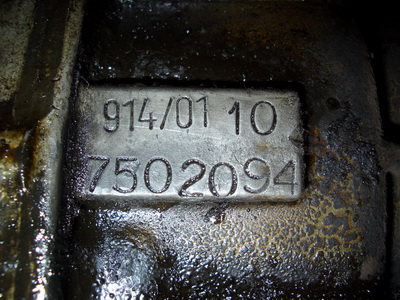

With help from Harald and Gustl, I have added a number of photos of serial numbers. I also have some additional photos that Gustl has sent that I still need to add to the article.

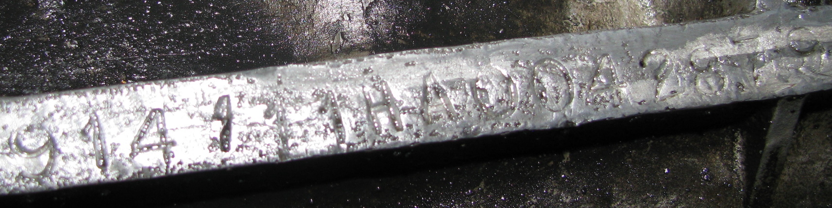

According to the charts at the web link above, the /11 & /12 on 914-4 tranny's refers to the tail or side shift configuration respectively - although that info may not be completely correct -
unless the basic case was interchangeable for tail or side shifter setups?
I say this because my mechanic - Hans of Hans Imports - had used a "used replacement case" to rebuild my early 73 2L side-shifter back in 12/83, when it's original case was too worn-out inside to use - see the pic of my current used case # below:
"HA" transaxle # used in rebuild for my 1973 914-2.0 (VIN 4732901954 & Engine GA000424 & still matching nos. from 9/72 build date):Click to view attachmentSorry to add to the confusion here, as I was only drawn to this post to figure out what LSD stood for, after seeing it in the parts forum!
...but hopefully it adds to the forum, & feel free to use it on the tranny article - but please leave off my VIN & Engine numbers there!
