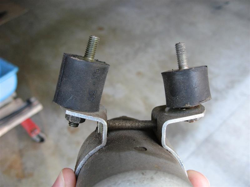

I found some at McMaster-Carr that were close but not perfect. They were either a little bigger or smaller. Haven't actually used them yet so I'm not sure if they are what you describe as the cheap version that breaks or not. They were less then $2 each. The one on the right is stock the left is the first one I got from Mcmaster, I went back and got one that was shorter. Check this thread also:
http://www.914world.com/bbs2/index.php?sho...c=92265&hl=
Kev

The ones that I call cheapo are from the local VW shop and don't look like they would last a year. Also, Rich at HPH said to steer clear.
These look like good alternatives. As long as they are not smaller than stock, I think they would be okay. Otherwise it looks like there would be clearance problems.

The whole point is to hold the pump in place and to vibrationally isolate the pump. Either one of the McMaster Carr ones would work but it might shift the frequency of the transmitted vibration up or down a little.
If you are in the store, bring an old one and do the thumb nail rubber durometer(hardness) test. If one is a better match in durometer to the factory part, take that one. Too soft, and the rear mounted pump might sag against the metal of the car, too hard, and it will be transmitting more noise.
