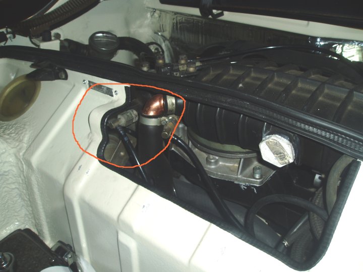

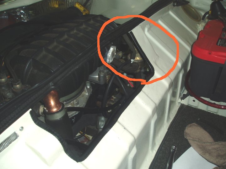

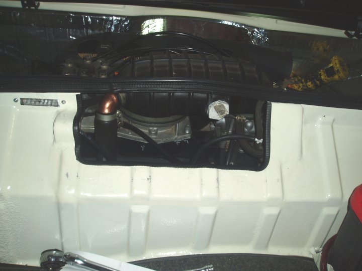

Wayne at Pelican claims to have installed a CIS motor w/o having to cut the trunk.
