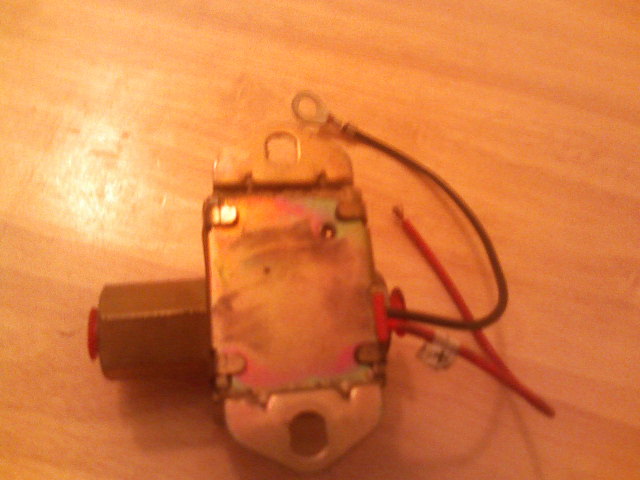

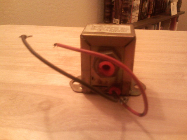

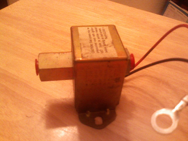

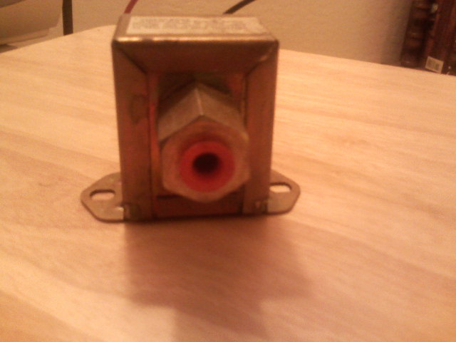

Hey if your pump is screwed then i have a 12v fuel pump that used to be on my car. It's not stock but It works well, i just recently tested it. Here are some pics:
Click to view attachmentClick to view attachmentClick to view attachmentClick to view attachmentif you want it just let me know, i'll probably just give it to you or whatever.

The above pump won't work. Low pressure pump for carbs.
