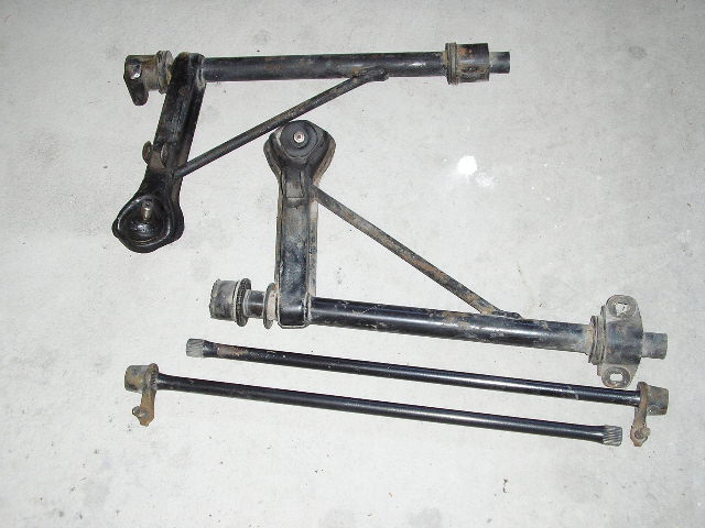

This may be a really dumb question, but the front end of my car really need to be lowered and the adjusters are rusted stuck. Ive tried everything, penetrating oil for days on end, locking pliers, bolt out on a ratchet. the allen is rounded out as well which makes matters worse. I saw a picture of the torsion bar and adjuster out of an a arm, is it possible to pull the torsion bar and adjuster or should i just pull the whole a arm off to work on the adjuster part?
If i pull the a arm, i take it that means i need a front end alignment done, right?
Heres the picture i saw, that made me wonder if the adjuster and torsion bar can come out with the a arm still attached to the car

You cant get the adjuster cap out of the from a-arm without removing the adjuster first.
Try vice grips and heat first to get the adjuster out.
If not, you could cut the adjuster bolt off and get used caps from the classifieds.
Rich
You can remove them with the a-arms still on the car.
But the front must be unloaded. A pair of jackstands will do.
As for the alignment, any change to the ride height will require you to realign the car.
So plan on doing that no matter what.

So i need the adjuster bolt out to remove the adjuster and torsion bar. How difficult is it to remove the torsion bar and adjuster cap?
The front end is already up on jackstands, no rotors on the spindle, everything else is just hanging down, i take it the front end is unloaded as the car sits on the jackstands right now. With the front end unloaded, will i have to worry about the torsion bars being under any load at all?
Alright, not to worried about the alignment then, just want to get the adjuster cap off the car
The bolts need to be out and the cap should just come off. If the TB are rusted, they can be a bitch to remove.
On the other end, towards the front of the car, there's a round cap on the a-arm that you can remove.
It's a bit tricky to get off, but you can then whack the TB from the front and see if it moves.
smash.gif Andy
