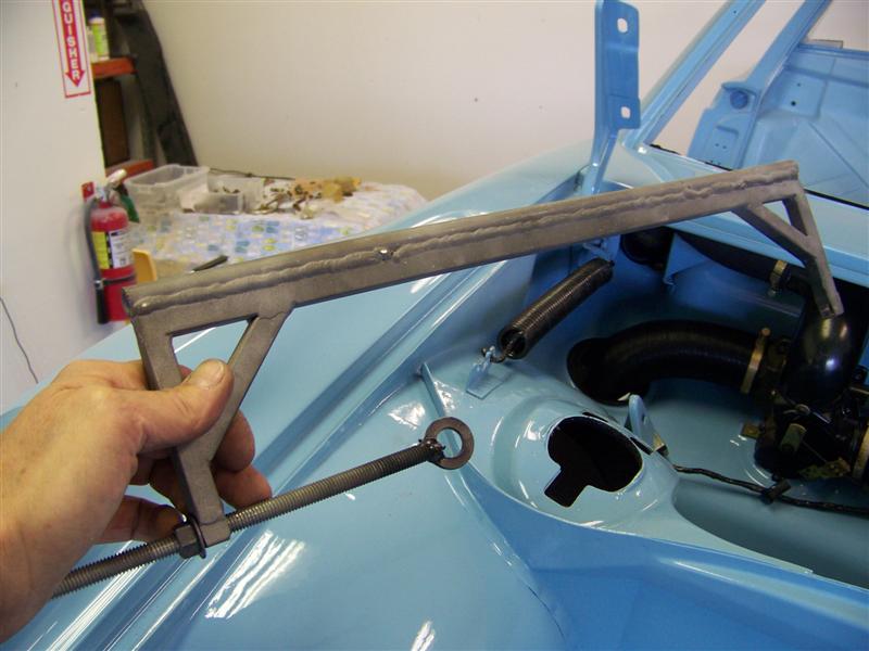

Click to view attachmentLine everything up and tighted the bolt. The spring slowly gets longer and you slip it in place.

Am I the only one who did this by hand with no gloves and had no issue?
Was a little tough sure, but I got them stretched.
Gint
Jul 6 2009, 08:35 PM
No. It's a mind over matter thing I think. It looks worse than it really is. I had to be talked into the first time I tried it. But afterward it was no big deal.
ghuff
Jul 6 2009, 08:40 PM
I did have visions of the spring slicing my hand open if it slipped but decided that I really wanted my hood to stay up by itself at the time after I spent too many hours prepping the seal install surface.

iamchappy
Jul 6 2009, 09:29 PM
I've never had a problem pulling them on with my bare hands, really it's no big deal, and i'm a wimp.....
I even have mine on the next loop up from yours!
Rand
Jul 6 2009, 10:18 PM
You need the gloves when you take them off... that's when they pinch. Putting them on takes two seconds.

jmill
Jul 7 2009, 09:38 AM
I use a cotter key removal tool. I had a few of them. I bent the 90 degree angle more so it formed a U. Hook the end of the spring and yank. It works slick. The first time I tried I didn't have the hook bent over 90. The spring shot off the end. If I had fresh paint I'd be bumming.

Spoke
Jul 7 2009, 03:41 PM
Nice tool. Did you make the tool for this purpose or is it for something else?
Your paint job is too nice to try putting the spring on by hand and potentially scratching the paint.
charliew
Jul 7 2009, 05:43 PM
I use a big spring hook and put a old sock over the spring and just cut the sock off when it's on. I've really never lost a spring yet though. You can get a big spring hook at the hf place. It's a long 1/4 rod with a hook on the end and a cross handle welded on for a handle. It works on lots of spring challenges such as some brake springs.
PanelBilly
Jul 7 2009, 10:06 PM
Tool was made by a shop that specializes in restoration.
