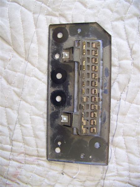

There was a hole in the OEM board for clipping on what I think is the turn signal relay (the square one). Where do you clip it on when you switch to the new style board?

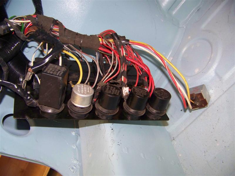

Here is a pic of the back of the stock fuse panel
Engman
It looks like you have the intermittent wiper relay inside the cabin.
It normally mounts here

There's five relays that have the rubber tree that press into the holes in the board. This box has a clip on it and in the original board there's a hole for it to clip on.

Its one of your panels, but I bought it from another member who bought it new and never installed it. Here's a photo of the OEM panel. The relay clipped in the two holes in the lower left corner

If the car is 72 or later the Turnsignal relay is mounted in the dashboard NOT on the relay plate.
montoya 73 2.0
Isn't the large black rectangular relay the turnsignal and the silver square one the dimmer relay? My Turnsignal relay is mounted under the dash on that lip next to the headlight switch.
