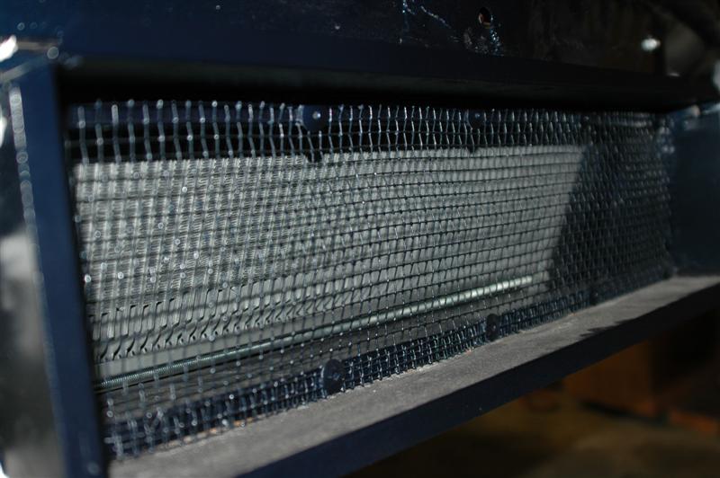

Are you referring to the standard cooler? I have seen one with the cooler mounted to the grate above the engine as well as ones with the cooler under the rear trunk. Both with thermostatically controlled fans.
The current 6 is a 914-6 engine (not 911) but is not original to this car.
