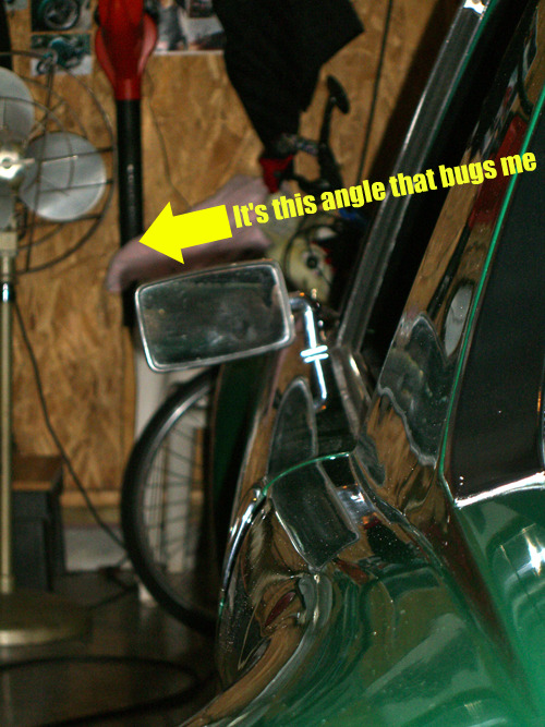

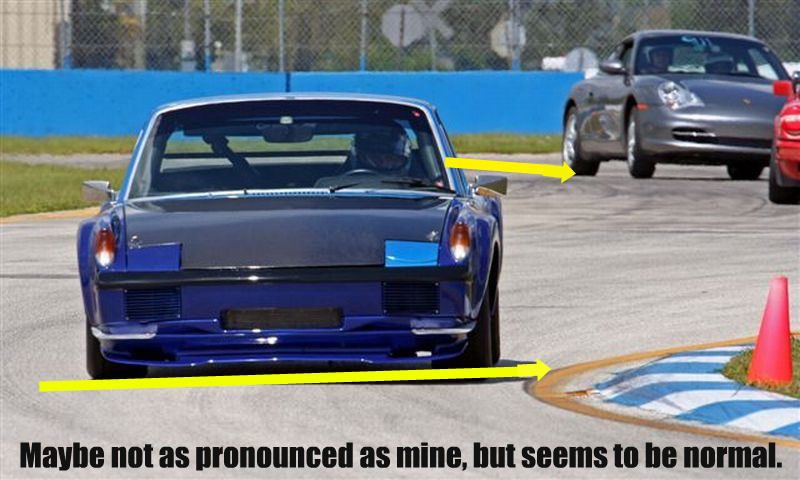

kenshapiro2002
Aug 13 2009, 11:11 PM
It's the angle shown in this photo that bugs me, not really the in/out or up/down adjustment. Maybe some kind of base shim that lifts the outside edge...

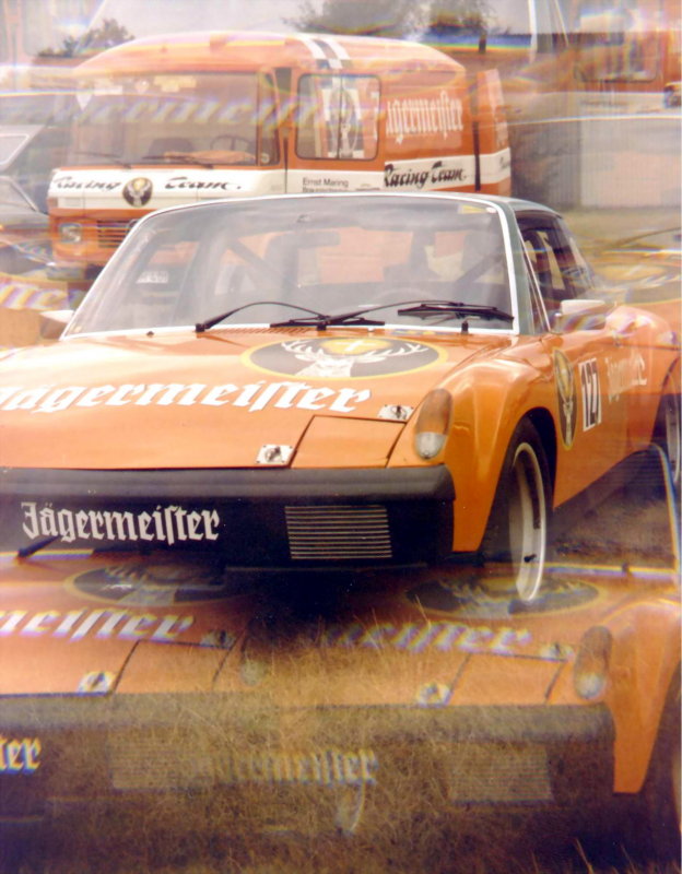

6freak
Aug 14 2009, 02:55 PM
QUOTE(kenshapiro2002 @ Aug 13 2009, 10:11 PM)
Click to view attachment It appears to me they were mounted in the wrong spot ...Need to be on the top of the door next to the seal ,,,,jmo...just looked again and i dont see plastic shimmy thingy under it ....
6freak
Aug 14 2009, 03:00 PM
Click to view attachmentFactory mirror in factory location ..1970 model

kenshapiro2002
Aug 14 2009, 03:12 PM
Nah...they're right next to the seal and the plastic bases are there. You have made that light bulb go off for me though...I'm going to create a replacement shim that is thicker on the outside edge to lift the whole mirror into a horizontal plane. Thanks!

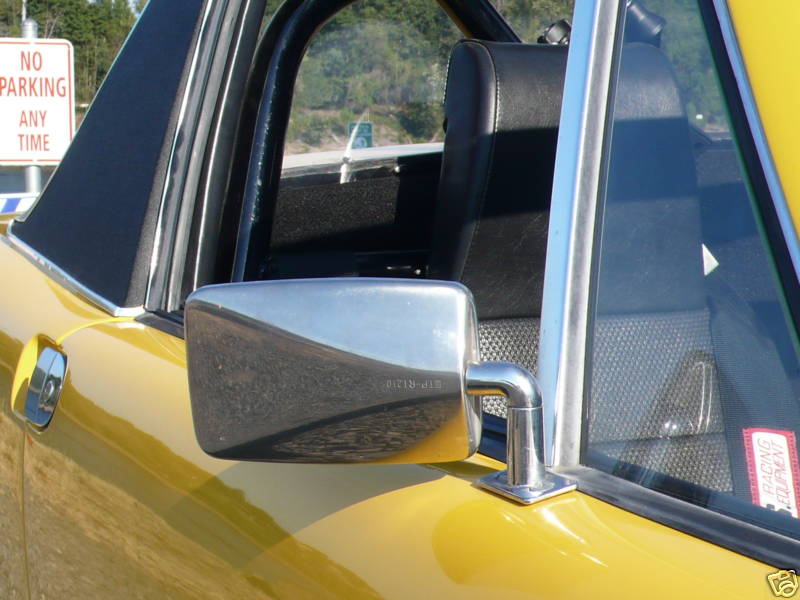

schreiber
Aug 14 2009, 10:03 PM
I'll trade with you. I'll even cover shipping.
See picture

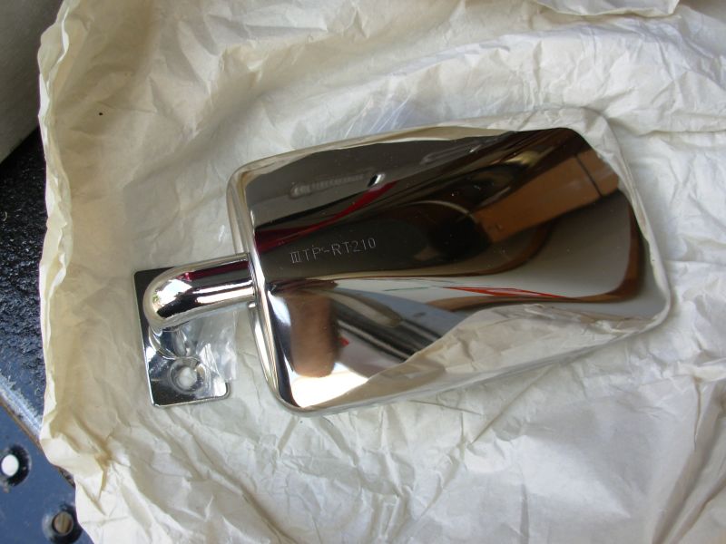

I use to think other mirrors (911 flags, 993, etc) were nicer on a 914, but I've come back around to the stock mirrors. Even if you switch, if I were you I'd keep the stock ones in case you come to your senses.
T.C.
Click to view attachmentClick to view attachment

tat2dphreak
Aug 15 2009, 10:54 AM
completely remove it, turn the base round and put it back, I bet you will be shocked
btw TC those mirrors are sick. I don't think I've seen any quite so shiny

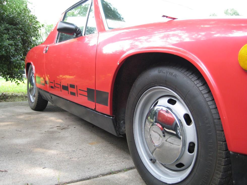

kenshapiro2002
Aug 15 2009, 11:52 AM
I
was shocked...the mirrors were wayyyyyy off then. They are mounted correctly. Here's another shot to show the slope. Maybe I'm too anal, but I need to get these guys level...mostly a safety issue, they just don't show what's behind me that well.
Click to view attachmentQUOTE(tat2dphreak @ Aug 15 2009, 12:54 PM)

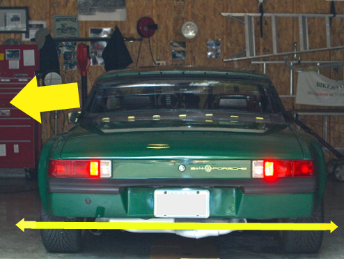

kenshapiro2002
Aug 15 2009, 11:53 AM
Hey...can some of you get behind your cars and tell me if mine is normal or not?
Ken
carr914
Aug 15 2009, 12:00 PM
carr914
Aug 15 2009, 12:05 PM
kenshapiro2002
Aug 15 2009, 12:22 PM

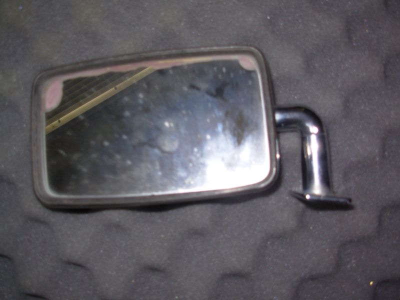

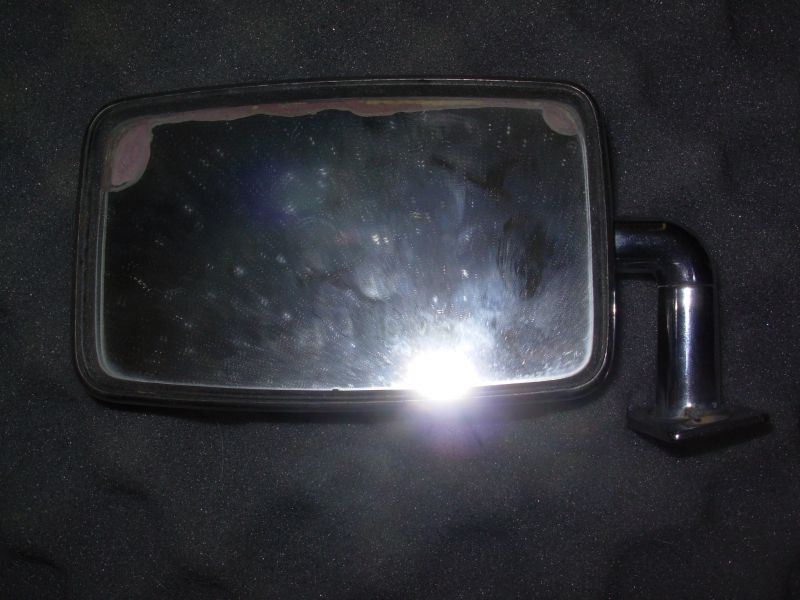

carr914
Aug 15 2009, 01:20 PM
Hopefully this will help better as I grabbed a mirror out of the garage
T.C.
Correct position of the base
Click to view attachmentIn-Correct 180 out & will give you that weird angle
