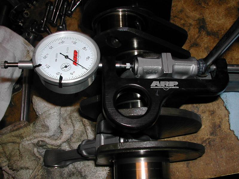

So someone tell me about this stretch gauge. How is it used? To check old bolts? Or is it an alternate way to measure the tightening. Just curious.

Rod Bolt stretch Guage....use....The guage is placed in such a way so as to measure the total stretch of the bolt at ANY TORQUE....USE the guage to measure the O.A.L. overall length of the rod bolt (WITH OUT THE NUT IN THE WAY BEFORE TORQUING)...this gives you the BASE LINE LENGTH of the specific rod bolt.(JUST for that specific rod bolt)....so you have got to take notes like real ENGINE builders do. ..so you get the O.A.L. of all (8) bolts individually. Install the rod bolts into the bottom cap...insuring that they are absolutely flush, seated....install top rod cap..tighten the new NUTS by hand easy, ..back and fourth, numerious times. YOU can feel the resistance , by hand , until the NUTS are seated on the upper rod cap., and the rod seperations..bottom and top cap is flush and secure...BUT NOT TORQUED. ...the ,,guage.. is made insuch a way that you can measure through the top rod cap NUT opening to the rod bolt itself , the bottom is the bottom of the rod bolt....Then ....with the specifications/ recommended for torque and rod stretch ..proceed to Torque the rod nuts/ bolts.(back and forth as you should do)...toward the rod nut torque specified....now What I specifically do is to keep shy of the FINAL torque recommendation by at least ..(2) two ft. lbs....I measure the rod bolt stretch..and compair it to the torque recommendation. if the bolt is stretched too much at this point.. that bolt must be replaced..even if its new, it has a defect somewhere. AND, I use a brass hammer, at this ..NON FINAL ..torqued stage. gently but firmly tap on the bottom of the rod bolts...to ensure they are completely seated. then walk off and give the assembly a opportunity to normalize itself. ( usually overnight). The FINAL 2 lbs of torque are applied and a final confermation check of the ROD bolt stretch is done. Each measurement is recorded., as you can reuse these bolts again if they maintain their diemensions... I made my own stretch guage,years and years ago..I use a Inch pound torque wrench.. to help ensure accuracy.( not a regular ft. # torque wrench)...(the CARRELLO rod bolt lubricants should be used for assembly...even if you use the A,R.P. bolts and nuts.

the beauty of using a stretch gauge is that you don't need a torque wrench. Geting accurate and reproducible settings, whether using the torque wrench or torque angle methods, is limited by among other things, your ability to carry out the tightening in one smooth motion. Having to stop, especially near the end point, is going affect the effective torque, regardless of your wrench setting.
Here's the gauge in use. Lube threads and nut face with special lube, mount and zero the gauge, then tighten until 0.012" stretch (3.2 carrera).

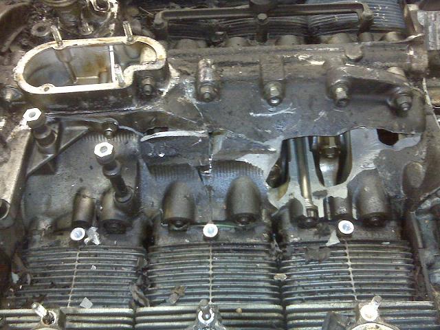

QUOTE(ME733 @ Sep 25 2009, 10:12 PM)
Bet you have never even seen a "914 porsche rod bolt failure....goes for 911 porsches also. (I am talking street cars) NOT RACE CARS.
I have..... and it was in a street car. A dead stock 964 Cab being driven on the highway at the time of failure.
Click to view attachmentThis is a picture of a 3.6L 964 motor. A broken rod bolt caused the #3 rod big end to separate. This caused lots of shrapnel that destroyed the top of the case, embedded pieces of the rod in the case. The flailing rod remains hit the oil pump and jammed it, and that caused the intermediate shaft to shear off. It also put some very large cracks in the crankshaft, and destroyed 4 pistons and three cylinders.
The top of the case in that picture came off like a banana peel. I could see the rods. I have already stripped it, but I can get a picture of the remains of the case if you like.
Rod bolts are cheap compared with the cost of fixing this type of damage.......
