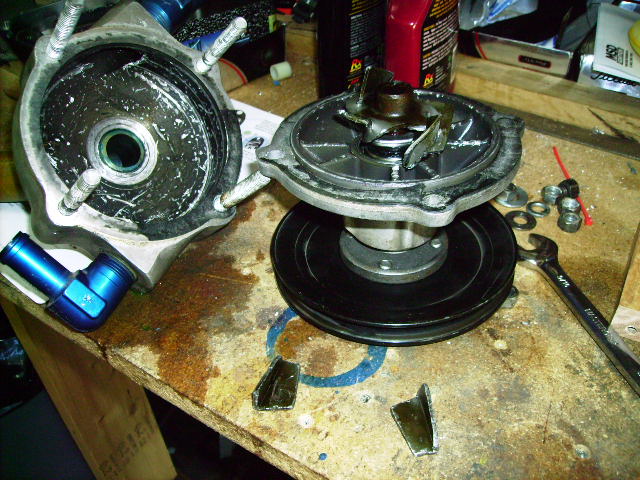

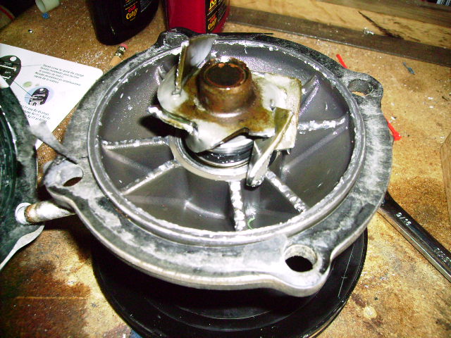

Here are pictures of the failed impeller and chewed up housing. Note the two impeller blades in the bottom of the first pict. one was jammed into the outlet pipe, hard.
BTW what is your best guess that would cause this??

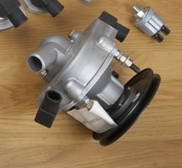

$335 WATER PUMP AND ASSEMBLY: Remote mounted water pump assembly mounts to the side of the engine and is belt driven from the harmonic balancer, effectively shortening the overall engine length by approximately 5". Features our Renegade custom, cast aluminum housing, utilizing an aluminum Chrysler style big block impeller. Includes adjustable billet mounting plate, pulley, and coolant fittings. The flow rate of this pump is comparable to many high performance Chevrolet pumps. (Replacement impeller for custom housing = $99.00)

I'm leaning toward cavitation creating a " negavitive " pressure on the inlet of the pump, causing the impeller blades to "flex" when spun past the design. Like a piece of wire if you flex it too much it will eventually break.

It's cavitation problem as long as the water pump is higher than the water level
in the radiator it will cavitate.

Our water pump expert (30 years rebuilding) says that it is odd the impeller came apart. He feels that something got into the system .. rock, nut bolt, whatever becuase the bearing still looks solid from the image. If the bearing went, the impeller would have gouged the back housing.

QUOTE(TC 914-8 @ Sep 27 2009, 07:07 PM) *
