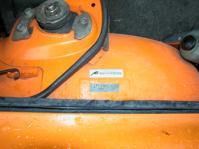

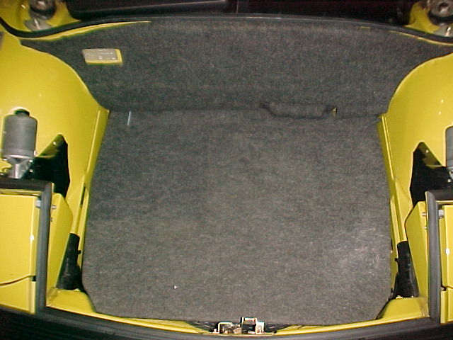

Your VIN can be found in three locations on your car:
- VIN stamped into the passenger side front fender well.
- '70 - '74 VIN plate riveted to the passenger side headlight bucket.
- '75 VIN plate riveted to the front firewall.

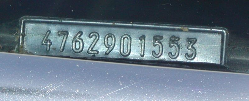

- VIN tag on the drivers side windshield pillar (USA only).
- On 914-6 cars, the VIN starts with "914", on 914-4 cars the VIN starts with "47".
