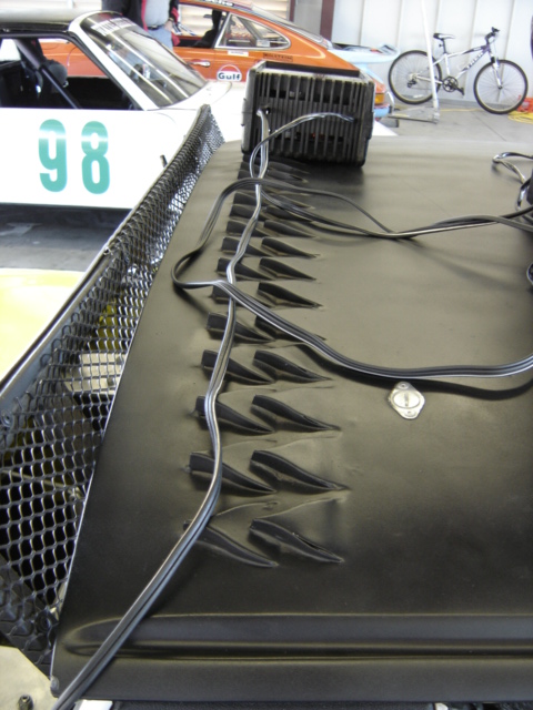

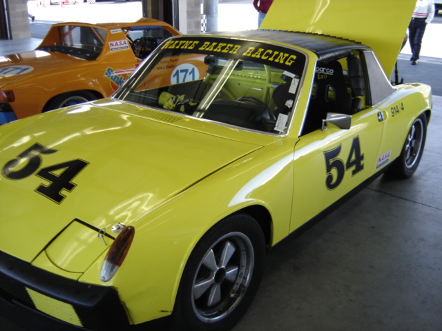

So does that explain the vortex generators on Wayne Baker's 2.0 4 cyl. car?

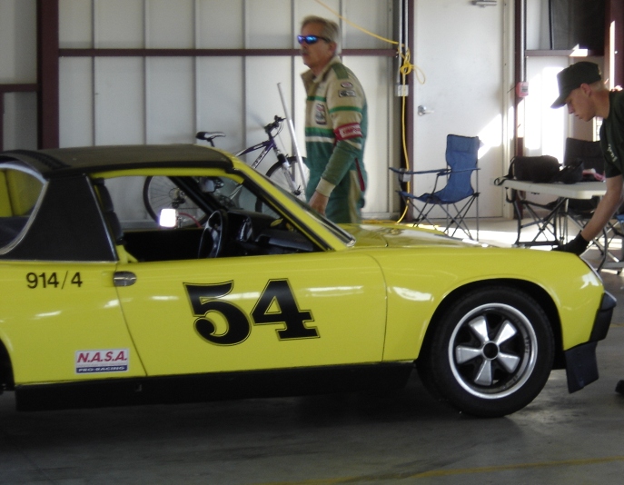

this is actually interesting- seems like years ago i read something about race drivers modifying there own cars with a slight bump , or ramp , amost like a TA spoiler on the roofs , to assist in the airflow over the car and while i cant recall where i read it i seem to recall that it also did just this same trick

Quick definition of Vortex generator at this link...here is the rest of the car, it decimated the 2.0 liter field that day with Waynye behind the wheel. He told me he would let the 2.0 six cars by so he could re-pass them.
http://www.aerospaceweb.org/question/aerod...ics/q0009.shtml

Another...

have you seen the ferrari racers? The ones with the exotic panelwork use little aluminum tabs to disperse the air randomly infront of those ugly panels. It seems that having the air broken is more predictable than having to calculate the downforce on those tabs.
What is the proper term for the really long flare things that stick out and look cool anyway. That one california company makes a kit for the 914 to make it like that.
Anyway, some ricer; the WRX or a toyota, uses dispersion tabs on the roof too. They are very uniform up down nubs. Like one side of a zipper. Only like 9 tabs on the roof though. so they're big. The article i read on it paid reference to audi doing something similar in the old days........

Wayne is a pretty fast driver, IMSA and Sebring champion remember. At the Palm Springs Revival race in November he was holding off Tommy Thompson's 2.8L RS based 911 with that same 4 cylinder car!!!

Wayne is also a very nice guy. It was a joy to speak with him. That roof panel was 100% custom. It was also very thin. Definitaly not just added to an original roof. You can see it has DZUS fasteners on it.

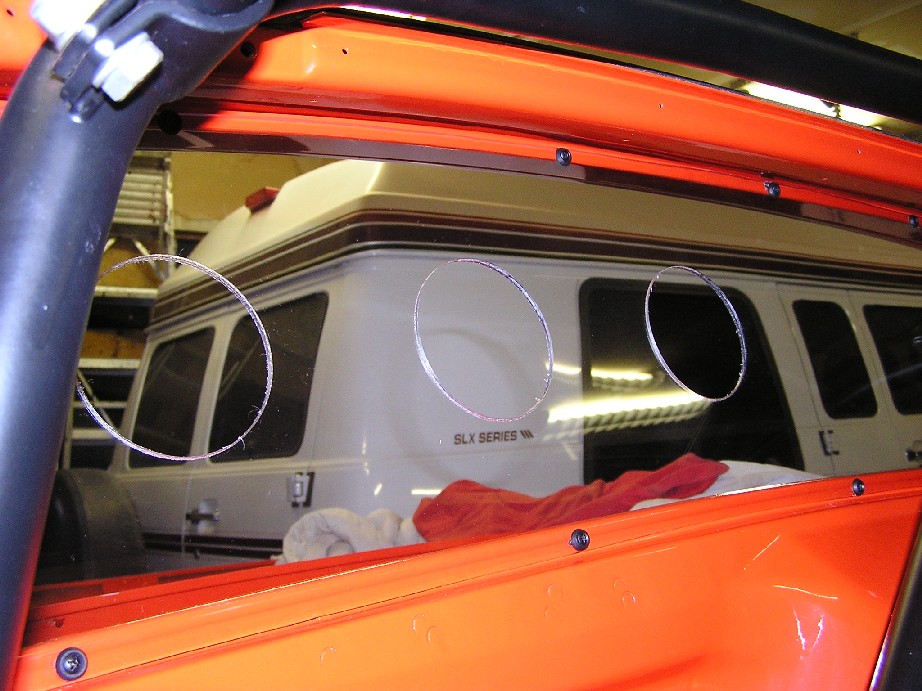

We did this...
I can't really tell you if there is a reduction in lift.
I wouldn't doubt it, but its just not one of those things I can absolutely confirm that I'm feeling.
The reason we did this was to reduce drag.
most of the race cars around here do.
if fact most of the GT type car either run no windshield and no rear window, or else a slopped windshiedl and only half of a rear window
here is our rear window.
we figure all the air coming in the side windows needs to go somewhere or else the cockpit is a huge sail:
