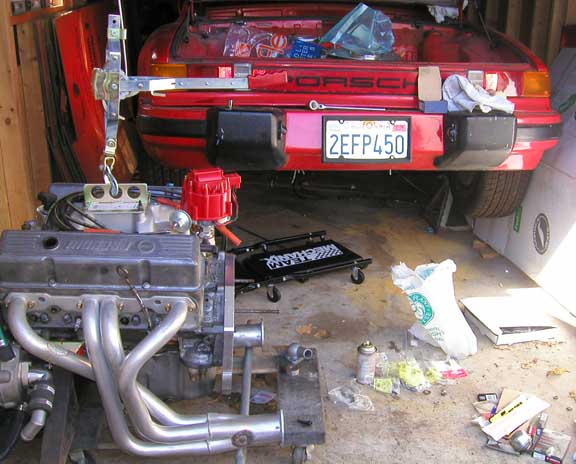

I know the cyl order, just not sure which plug wires orient on the dist.
Where's Levi when you need him? (IMG:http://www.914world.com/bbs2/html/emoticons/smile.gif)

Twystd1   Put the balancer on the engine. Pull #1 spark plu...   Feb 26 2006, 10:57 PM
messix   find tdc on #1. install dist. rotor will now be at...   Feb 26 2006, 10:59 PM
messix   i doubt that the pointer will be accurate on whate...   Feb 26 2006, 11:03 PM

Twystd1   If ya have it dead nutz.. (I would) Messix is corr...   Feb 26 2006, 11:46 PM
neo914-6   Thanks guys, The HEI rotor is not as "pointed" a...   Feb 27 2006, 03:24 AM
Crazyhippy   These guys got it covered, just be careful w/ the ...   Feb 27 2006, 02:37 PM
efeinsmith   If the distributor was removed, then the static ti...   Feb 27 2006, 06:33 PM
